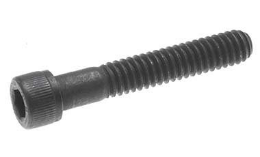

I like to use these.....can get them at the hardware store and don't need to grind the heads.
