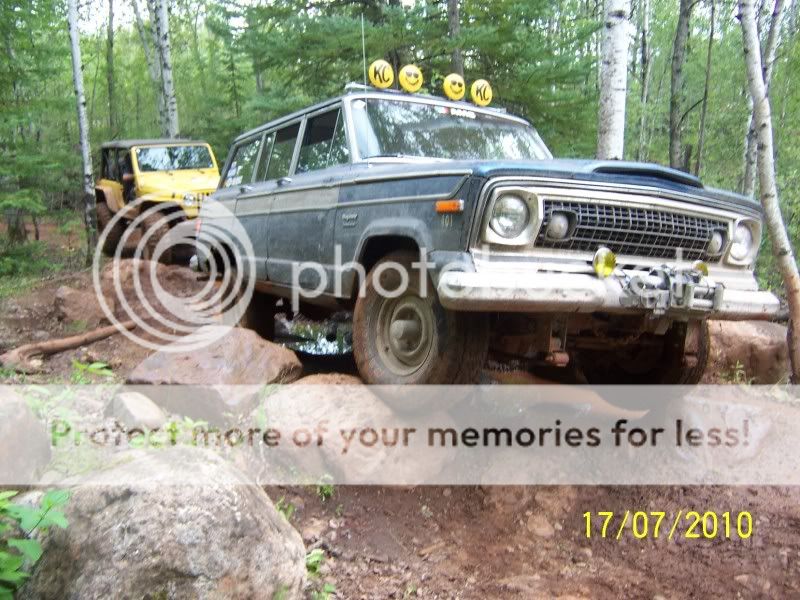

The jeep is already lifted but the front has shackles and they catch on everything.Here's a pic.

uhhh..... anything is better than that ghetto fab front shackle hanger thingy you have in there now!!
