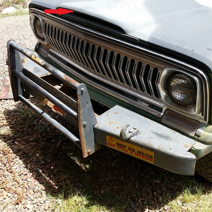

Where it's at on a 74' Cherokee.... mine at least.
In the hole on top at center, lift up

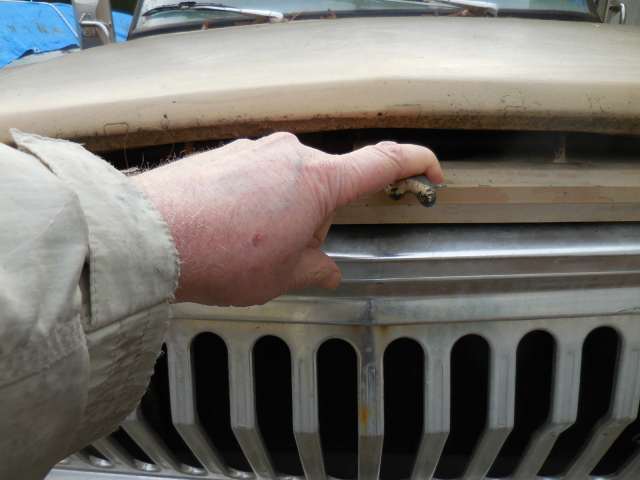

Originally Posted by Heep-J4000
Did a Google search and the other jeep forum shows a couple pictures of the hood latch mechanism from the full size Jeeps.
https://www.fsjnetwork.com/forum/viewtopic.php?t=13135
That link won't help the original poster. It shows the later style with an inside cable release. The earlier models have a release lever that's between the hood itself and the "hood bar" that is located above the grille. See MWood65's picture. On my '77 it hinges out, not pushes up.
That's interesting. Wonder why they changed it, makes no sense to me if it works why change it?
Probably because you can get more leverage than the lift style, maybe easier to access, since they were becoming more mainstream vehicles.
Not to echo Art, but my guess - the earlier type push-up type was hard to operate. The lever is an improvement.

Good picture, Reese. I like the side lever myself, but the flat flippers usually worked fine. My '78 has the lever, but I think the '77s and '76 I had all had the flat flipper...all pretty much were just variations operating the same thing in the end. Don't recall when they went with an inside release, but I think the outside all continued similar even well into the 80s.
