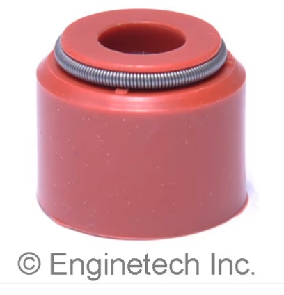

I believe I have leaking Valve Stem Seal on #8 Cylinder.
If the Head has Positive seals, which I read require some machining of the stem, can I switch to Umbrella type? Once I have the old seals out I will post a photo. Blue smoke and badly fouled plug on #8 ( Passenger side rear)
Good compression across all cylinders. 150Psi cold engine, 8 cranks, all plugs removed.

Turns out I have umbrella style
They look like Enginetech Premium. The spring at the top threw me off

Enginetech Part #
Catalog says Part# S288-20 ( 20 pack )

Enginetech S2886 look like what the engine builder used on my engine.
Regardless, that's what I bought to replace the damaged one. Seems fine.
