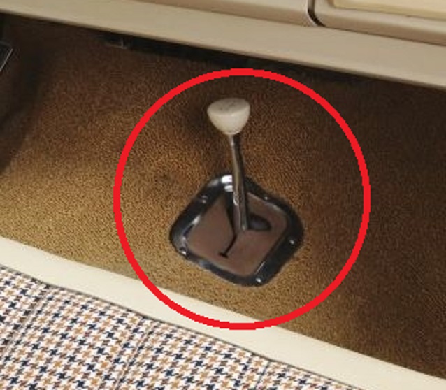

I have the rubber piece on the floor as shown in pic but under that is just a hole in the sheet metal, you can see the ground through the rubber slot.
I figured there HAS to be something under the floor to seal the hole but can't find anything on sites for sale or anywhere else. I can't even find a picture so I know what I am dealing with.
This is what I have now ...

The upper piece you have is still looking good so keep that and put a shifter booth upside down in between the body and the upper piece you have!
Lining up the holes or finding the existing holes could be difficult with everything together at once!

That pic isn't my jeep but it is the same piece. Just didnt have a camera handy to take a pic of mine...lol
Wish my carpet looked that good.
