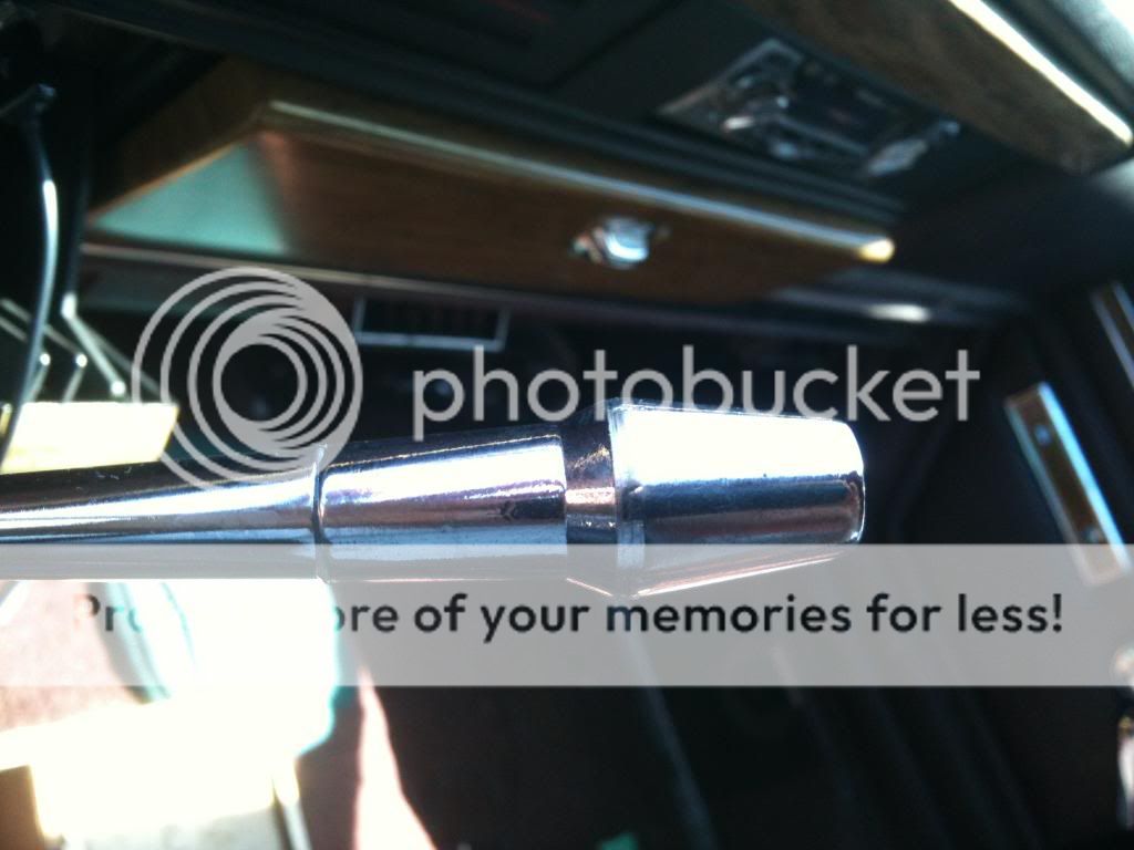

early shift knob on late column.
looks like they were made for each other. early 60's auto column knob on my '91stalk. had to drill and counter bore the hole in the knob,and a lil' jb weld....bam!
no more loose squishy gross rubber knob.

Nice one. What's the sleeve that goes around the column that the shifter nob is attached to? As you know I had a little mishap yesterday.
