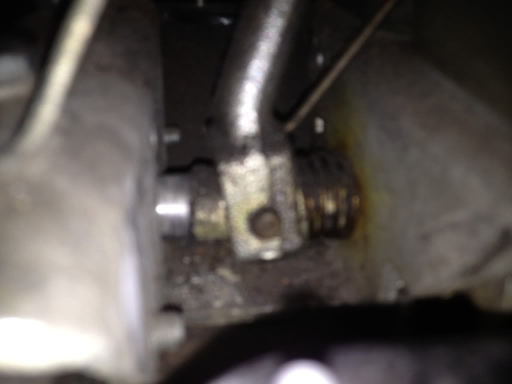

This is what mine looks like. Straight bar. The pin or retention spring in at the bottom in the console housing. Meaning you need to kinda push down and to the left to engage into the shift track. This was from a 1414x
Can take a pic of the mechanics if you want later. B

Here are some close ups of my Center Console shifter and the spring that holds it in place or from shifting by it's self.
Spring clips from inside to hole in side
Under Console Spring Mount
