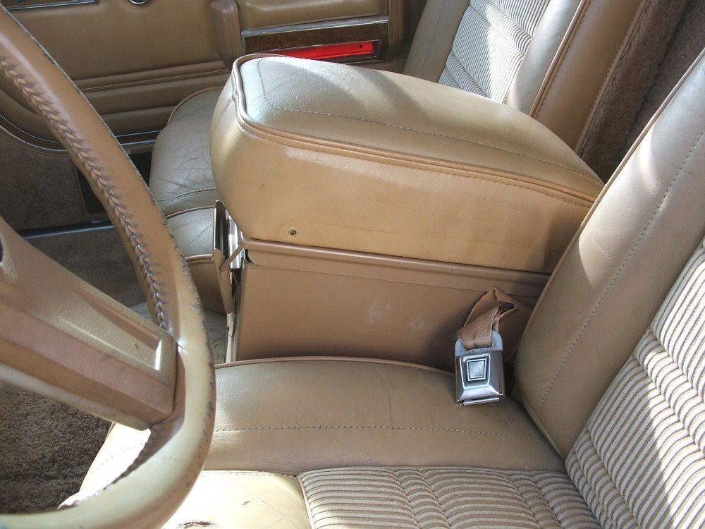

Years ago, on my '77 Chief, I modified the armrest. Back then, when CDs were the hot ticket, I had a massive collection of them. After putting a nice Alpine stereo with 6x9s in the doors, I needed a place to keep the CDs. Noticing that the stock armrest had wasted space under the base, I took the upholstery off, and using a hacksaw, cut the rear base off and attached it to a wood base I had made. I was able to fit 30 CDs in there, plus keep the armrest top functional.
Fast forward to now... The Chief is sadly long gone (totalled), and I decided to do another one. My goal is to have a functional original armrest, with a modified base containing a hidden compartment and a drink holder.
First I had to find one. After buying one fromLycanthrope, I had the top part re-apholstered. Then, after taking the bottom vinyl off, I carefully cut the off the rear part of the stainless steel base/frame off.
Then, I made a wood base with pre finished maple scraps left over from a cabinet job. The outer width of the base equals the inside dimension of the metal, which when slipped on to the new box, fits perfectly.
Then I fastened the metal rear to the wood box with multiple sheet metal screws.
More to come soon!

This is the way I done mine.

That looks nice. Is that an ammo box?

With the OEM base for the top?

Yes it is and as you can see I turn the base around.
