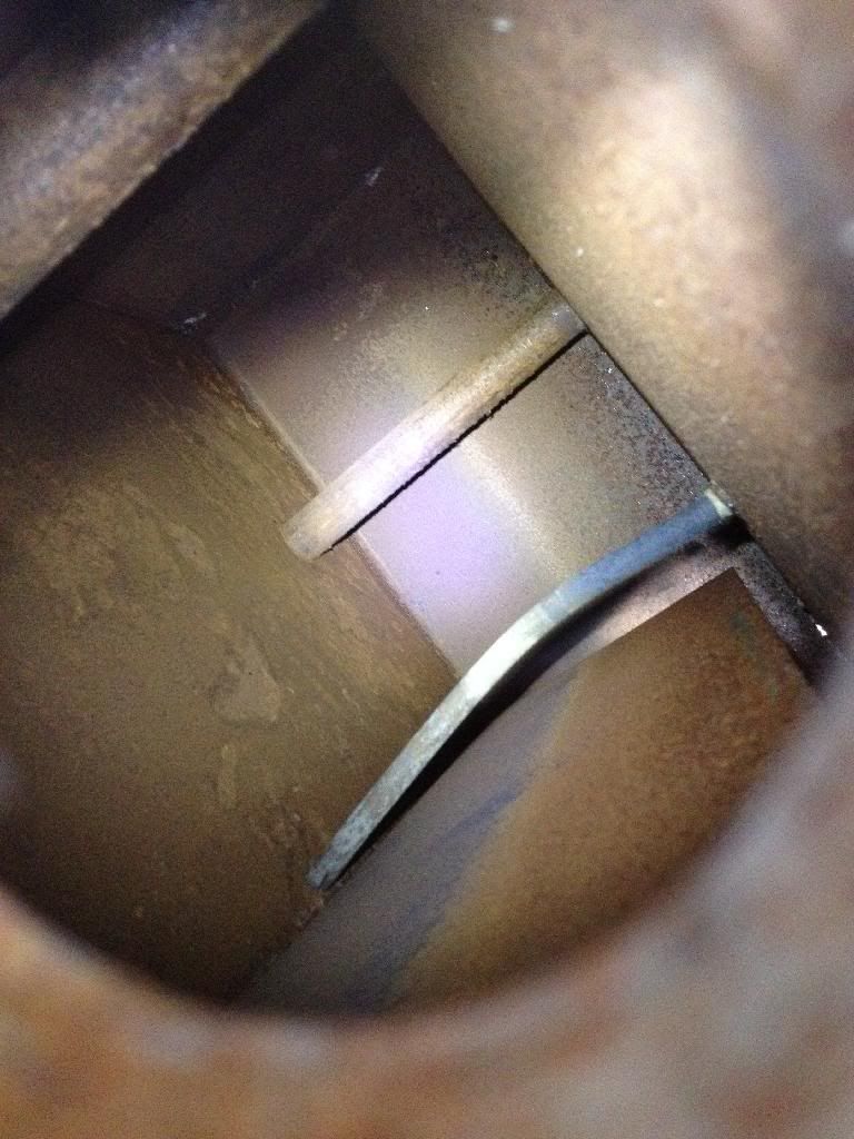

    When I bought my jeep a previous previous previous owner had installed an auxiliary gas tank. My previous owner had removed the coffin because they thought it was rusted and clogging the carb (turned out to just be vapor lock, derp). So when I bought it it was just running the rear tank. I eventually pulled out the rear tank and went back to the original tank for simplicity. (it's hanging down low in this pic, thats not where it mounts)
    Looks like it sat for a while with "some" gas in it.
    The Aux tank had no provisions for a vapor recovery system, and when i pulled it i found it was nasty inside. solid as a rock but rusty. Outside dimensions put it at 22 gallons. So, lets say 21 or 20 based on filler location, etc. I figure thats okay, its about the same as stock so i wont be LOSING anything.
    Pro's over a bronco swap: I already have the tank, I know how to mount it (re-drill 3 holes I welded up), and it wont require any fab work to the jeep, also it lines up with the stock fuel filler location perfectly. Also, it's a pretty dang beefy material, and it hangs no lower than the hitch so shouldn't hurt departure angle at all really and its not super low in general.
    What needs to be done to it to make it function properly? I know i will need to clean/line it. I plan to convert it to a generic universal type fuel sending unit. 5 bolts vs. the 6 bolt on it now. Gasket will cover the old holes.
    1. I dont have a fuel return line currently, should I install a bung so if (when?) I go EFI it'll already be plumbed?
    2. Vapor recovery/venting. My current coffin tank has 2 lines that go to the check valve in the rear render well. Then these two lines go up to a vapor canister on the firewall, and then into the snorkel on the air cleaner. Is this necessary? Should I install 2 bungs for this and run it as stock?
    If one was to consider a bronco or other swap, what needs to be done or modified on that, to make it mount and to make it flow/breath right?

      Yes, new universal style sender would go in the same hole, so the gasket would cover the holes, or since this has been sitting empty for years, I could fill it with water and weld up the old holes. Either way, easy peasy.
      But back to the question at hand, does this need vapor recovery tube fittings and whatnot?

        if you don't need the vapor canister for smog id say no on the recovery line.
        but I would plumb in a fuel return for EFI.

            Just my two cents. What are you expecting the goop to do for you? If the metal is getting porous it might help for awhile, but if you expect it to cover/seal your existing crud or rust...don't do it. If the tank needs to be cleaned it needs to be cleaned. No magic pour-in cures for a dirty tank. I'm not big on tank sealers but if you use one the tank has to be CLEAN for the goop to stick. If you think rust/crud coming loose from the tank is a hassle, you ain't lived till you get the tank sealer sloughing off and plugging up your fuel system. Tank sealers stick fairly well to clean metal. Sticking to rust/crud/E10 deposits...not so much. If'n were me I'd get that tank as clean as possible (bare steel is good/perfect) and then just use it, sans any sealer goop. That plate steel box tank is easy enough to cut apart and clean thoroughly and have it welded back together. In Vegas I don't suspect moisture forming new rust would be an issue. Clean steel has worked well for fuel tanks for decades especially in the desert SW.
            Tank sealers...a bah humbug temporary fix even in a clean tank but when the 'temporary' period expires and you've got to start over cleaning the tank...you'll really wish that residual sealer goop wasn't ever in there.
            Clean it, bolt it up, run it.
            On a side note since you're in limbo about differential, driveshaft fuel tank shape/location compatibility don't rule out a custom plate alum(or steel) tank made to your specs. If the shop has the material in stock or you can wait till his next scheduled metal order/delivery prices are decent. If he has to special order and have the material shipped separately...you eat that added cost.
            Cutting/welding plate isn't rocket science. They're not building a support rib holding an airplane wing in place. Years ago I had a local shop build me two 250 gal fuel tanks from alum for my 40 ft commercial fish boat. Going by the "at the time" material/labor prices it was pretty good compared to the cost of fixing my existing steel tanks.
            Research all your options and put sealer goop on the bottom of the list.

                The aforementioned kit comes with everything for chemically cleaning it, not just pouring in a sealer. The metal is 100% solid, it's just got that dusty surface rust in there.

                  I used the Bill Hirsch tank sealant on my CJ-6 tank. http://www.hirschauto.com/prodinfo.asp?number=GTS The Hirsch product claims that it's alcohol resistant. As mentioned, cleaning is essential.
                  There are quite a few horror stories out there about the POR-15 tank kit. It'd probably be ok, but the most popular products seem to be Bill Hirsch or Red Coat. Read this pamphlet http://www.hirschauto.com/sealer.pdf - I believe POR-15 products are all MCU, so it's probably referring to them.

                      I would coat it. If it's rusty now, it will only not rust more if you keep the tank filled with gas. These tanks are supposed to be plated internally. When the plating goes they rust. No alternative to coating or replacing at that stage, IMO.
                      The process I followed was a box of 1" drywall screws and power washer detergent and shake shake shake. Rinse and drain, dry now? Drying after cleaning should be easy there. Run some air from your compressor or the vacuum into the tank to speed drying. Then the Hirsch tank etch, and the sealant. Allow to dry for a couple days. Took a summer weekend to complete.

                        gotcha. so you were simply saying to use a better product, but still just clean it best as I can (i had read the drywall screws and vinegar as well), then do some sort of coating.

                          It's not Red Coat instead http://damonq.com/red-kote.html "Red-Kote"
                          The motorcycle guys seem to really like this sealant, while the car guys go for Hirsch.

                            Vinegar? Where did you hear about vinegar? I would wash with detergent first, then de-rust or etch as needed.
                            AFAIK acetic acid (vinegar) does not have any effect on rust. I know that oxalic acid will dissolve rust. Oxalic acid is available commercially as wood bleach, and was the primary ingredient of old-fashioned radiator flush. Muriatic acid (hydrochloric acid) will also dissolve rust, but it will etch the steel and releases hydrogen gas when it reacts with iron.
