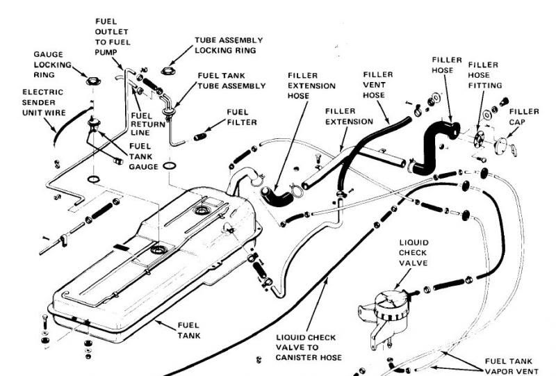

    Originally posted by mattparliament
    Where did you get that diagram? Is there one for the new Wags? I need it for my 91.
    Thanks
    Ed
    1991 Grand Wagoneer
    My 91 Phoenix Build Thread
    • #17
      Originally posted by e_digg
      Good looking addition to your wag!
      Thanks
      Ed
      It's from the service manual or "tsm", I believe I got it off www.oljeep.com, he has a bunch of nice resources there including the tsm for my 76 which I downloaded...
