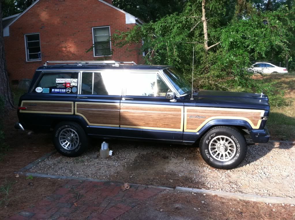

    As purchased in spring of 2010. 120+k miles. Worn out engine but decent body tub. Slow moving restoration and upgrade project very dependent on time and free income. Thus far I am on my 3rd job since beginning this project.

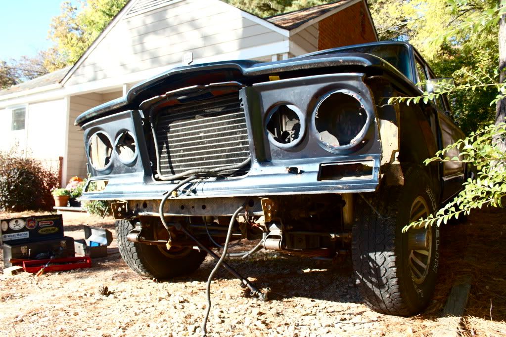

    Began repairing/replacing front sheet metal

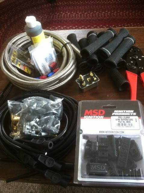

    Remaining parts arrived to complete another revision of the fuel line (going along the firewall this time). Making a set of proper fitting plug wires. Rewiring the ignition system between the battery and ignition switch.

    • Remove stickers from rear quarter windows

      Haha, they're gone.
