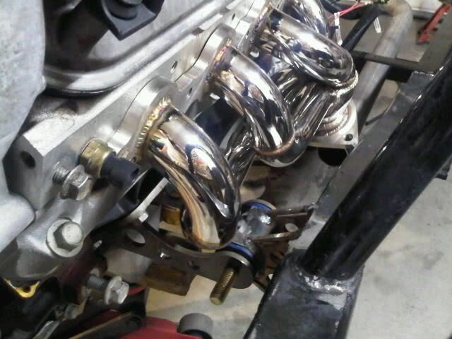

        Here are some photos of the 6.0 engine with the new covers.
        New OBX headers ready to be installed as well...
        I really think they make the engine look sharp though. And it's going to be even better when I get parts of the engine painted the body color or accent colors. It sure is going to help hide wires. They are very high quality covers that should last for a long time.

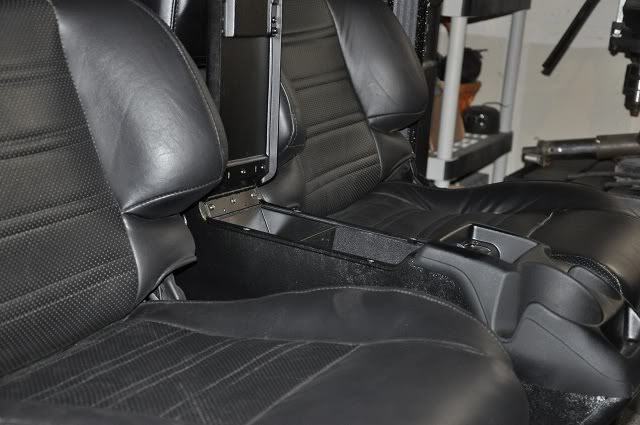

          Here are the new seats that will be going in the J200 now. They are shown here in my Willys wagon.
          The center console has a really nice pad for normal driving and I was surprised to see how large the console is when I opened it.
          I couldn't be happier with these. I like the low sides, because it will allow me to get in and out easily.
