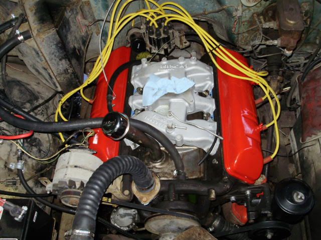

    I repainted my valve covers in red, which I like much better and I also pulled the intake manifold to paint as well. Replaced all the gaskets.
    Then I picked up a Rambler 4 barrel intake off ebay, which is waiting to be cleaned, painted, and installed

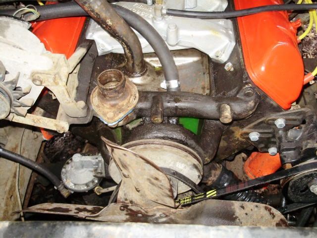

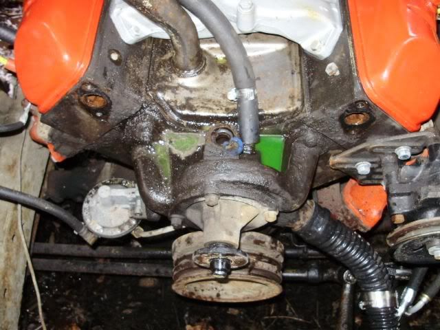

    Today I started tearing down the front of the motor. I plan to replace the water pump, timing set, and all gaskets, and paint all the parts. I'm stayin with the red...

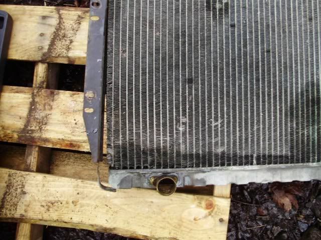

    I'm still waiting on parts so I haven't pulled the water pump and timing cover yet. I also need a new radiator, it's literally falling apart...

      But most of all I would REEELY ask that you consider a later AMC front face panel and rad support. That way you can have the larger AMC rads that are plentiful rather than having a custom made, and very small, OE 327 rad.
          I haven't ever thought of this, but a very interesting suggestion. I can't find a replacement and was sorta anticipating a rebuild of the one I have...

                  ignition: I haven't installed it yet, but I ponied up for a Pertronix kit for mine (you shouldn't need the ballast resistor)...got mine off Amazon for around $100..application numbers in my build thread I think). May as well do it now while you have access to it. Gear reduction starter (180 or so) from Autoelectrics would be a keen upgrade too, the old Pertronix is a long cold walk home in the waiting.

                  Radiator: yeah mine came apart like that too. I JB welded it back on, has held up fine. They are stupidly hard to find. Good idea on swapping the front metal out, didnt think of that, never looked to see if the inlet/outlets were in the same config with the 360 series.
