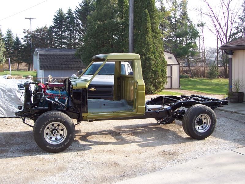

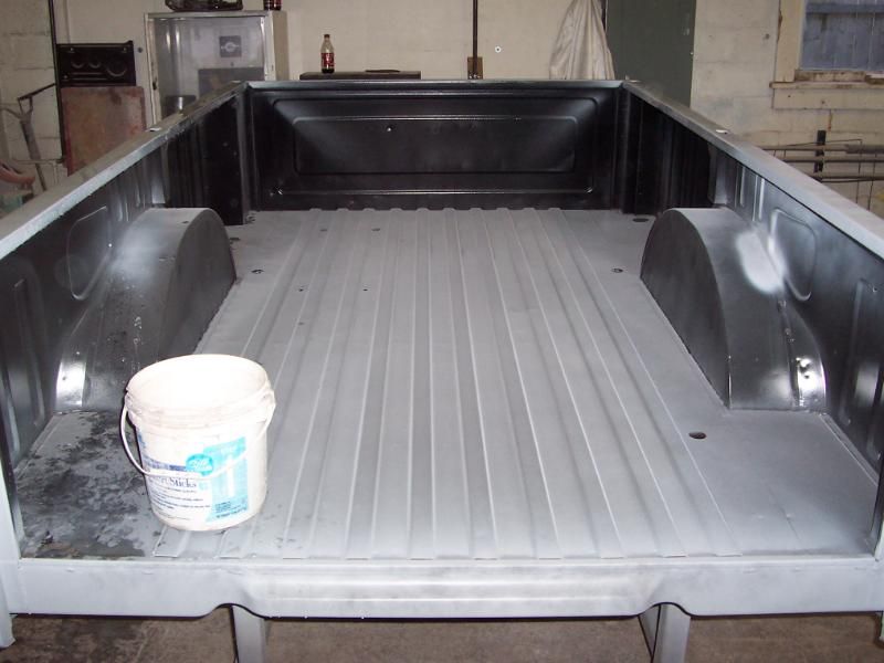

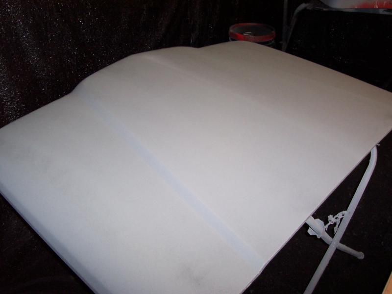

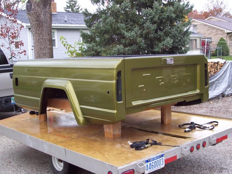

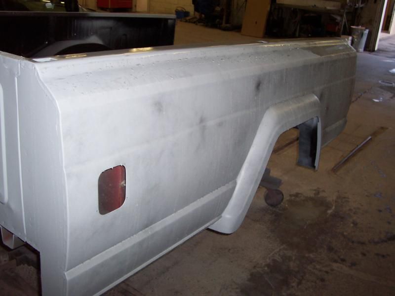

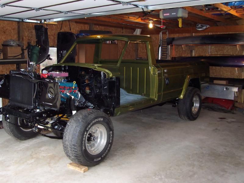

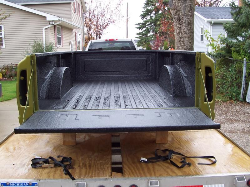

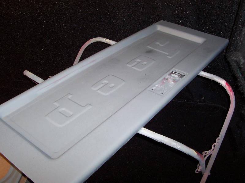

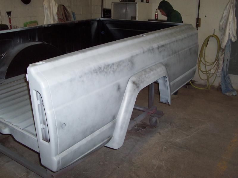

        Updating again....A few pics from the body shop. For what I gave these guys to work with , I thought they did a great job. There are a couple of things that will need to be fixed after I bring the assembled truck back to them.
        Many hours of ding removal went into the tailgate...$$$$$
        both of the fenders I bought from a fellow member here. My originals were in need of some serious repair.
        It doesn't look like it here, but the Box needed the most work. I almost scraped the box after they started. Was going to make it a flat bed truck, but my sweetheart convinced me to get it repaired. It turned out better than I expected.

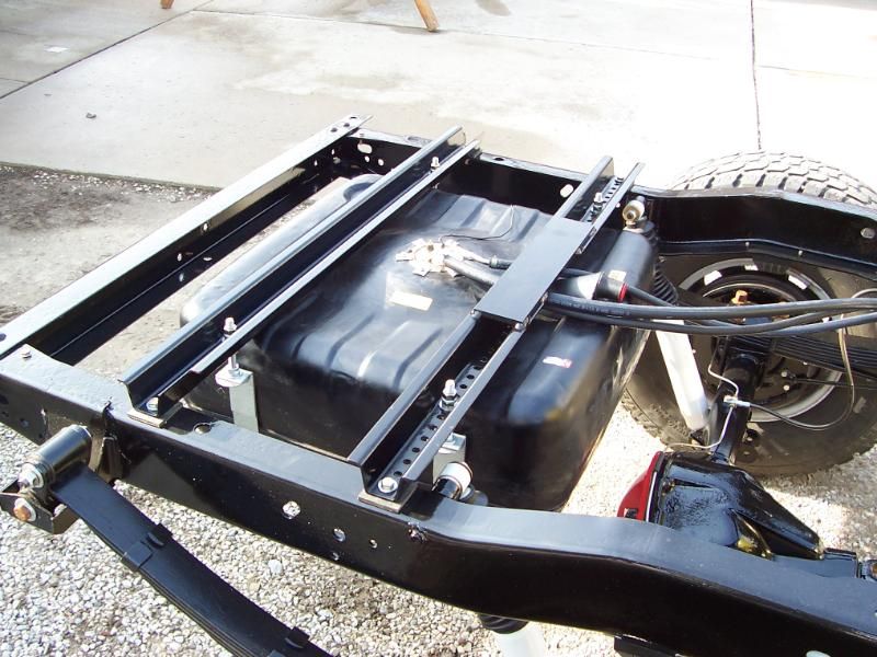

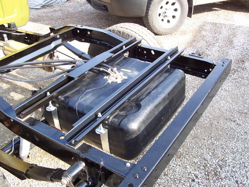

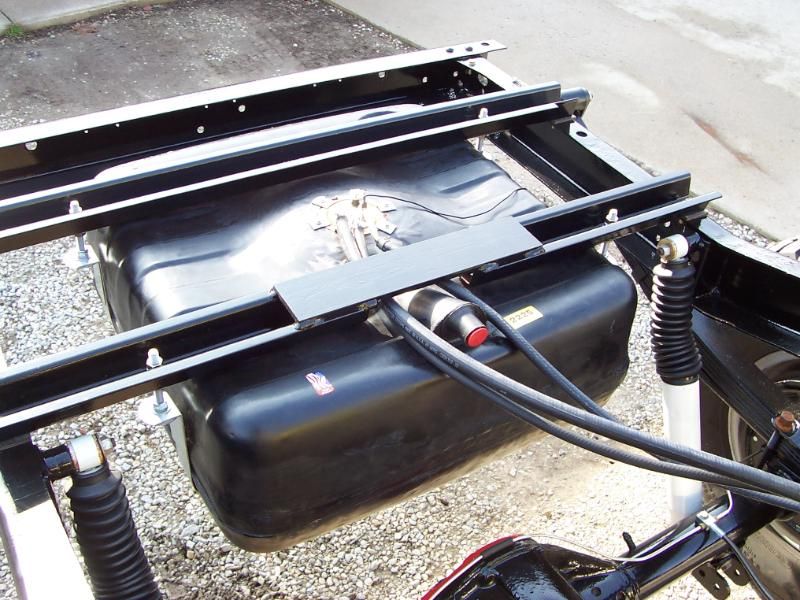

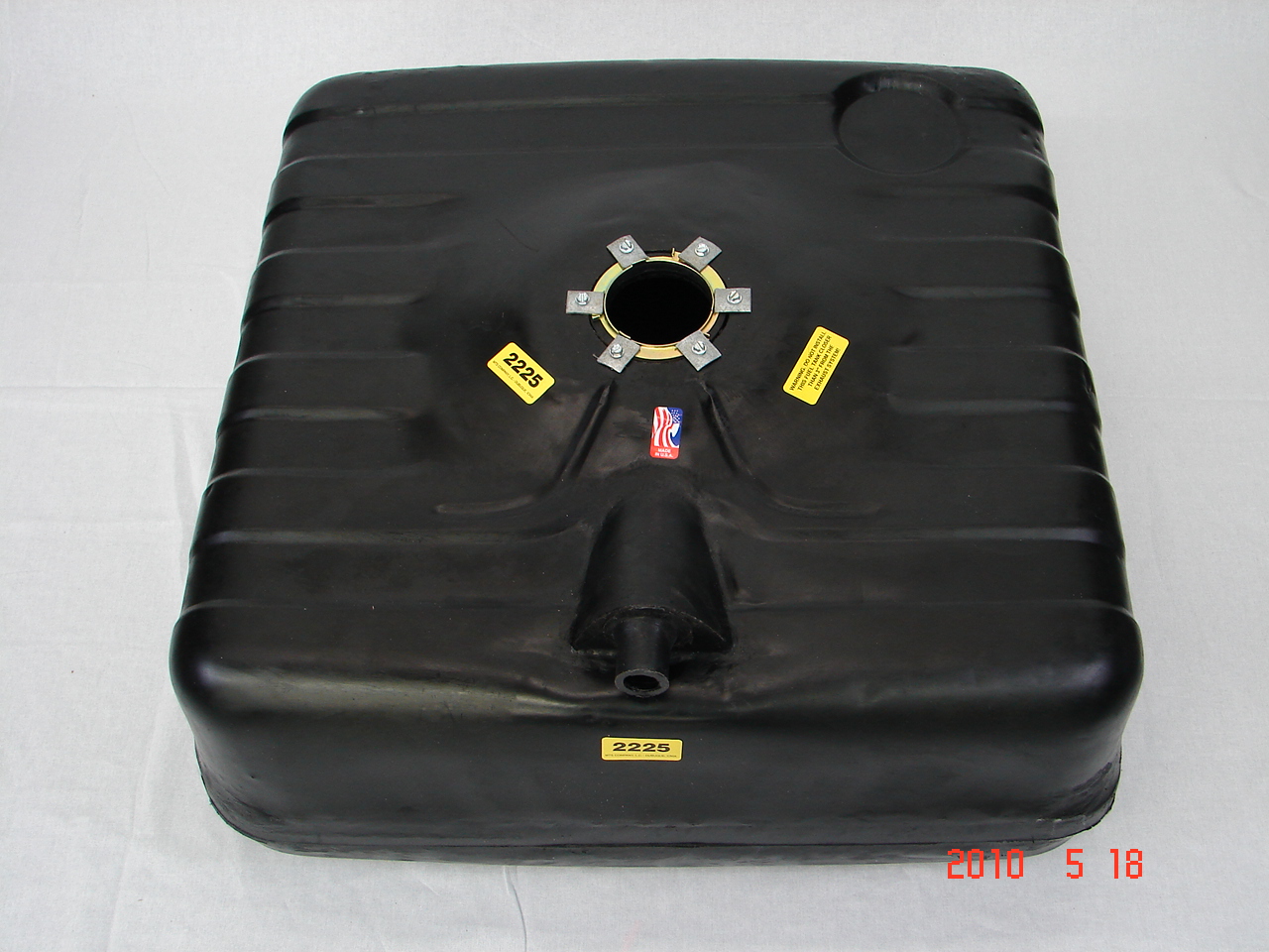

        Got the new fuel tank installed. Went to MTS supply and ordered a 25 gallon fuel tank and sending unit, that I mounted in the spare tire area. I could of went with the larger 31 gallon tank which is the same dimension but a couple of inches deeper. http://www.mtscompany.com/images/chevygmc/2225.jpg
        Found a site that sells the fuel hose I needed to complete the install.http://www.jmesales.com/catalog/gasdiesel-farm,4455.htm
        I'm starting to see daylight at the end of the tunnel for the first time. I still have a long way to go.
        Fuel system is now operational to run the truck.
        Lots to do yet, Dash is going in next. Thinking of scraping the stock wiring and going with new wiring from painless http://www.summitracing.com/parts/prf-10103
        Aftermarket gauges, and a tilt column thru Summit also, along with Corbeau moab bucket seats. BJS offroad bumpers are on the Christmas list, hope fully Santa thinks I was a good boy.........?

          What color green is that? Like it

            Rescue Green metallic....http://gtcarlot.com/colors/Jeep/All/

              Love the green too, great choice!

                WooWee, that looks good. The color is so nice and everything is done right.
                Thanks for the updates, it really helps my motivation.

                  Wow. Just WOW.
                  I've never liked that color, when Jeep came out with it for their (60th?) Anniversary. But it looks fantastic on that truck.
                  I can't believe how clean it all looks, you're doing an amazing job. Keep it up!
