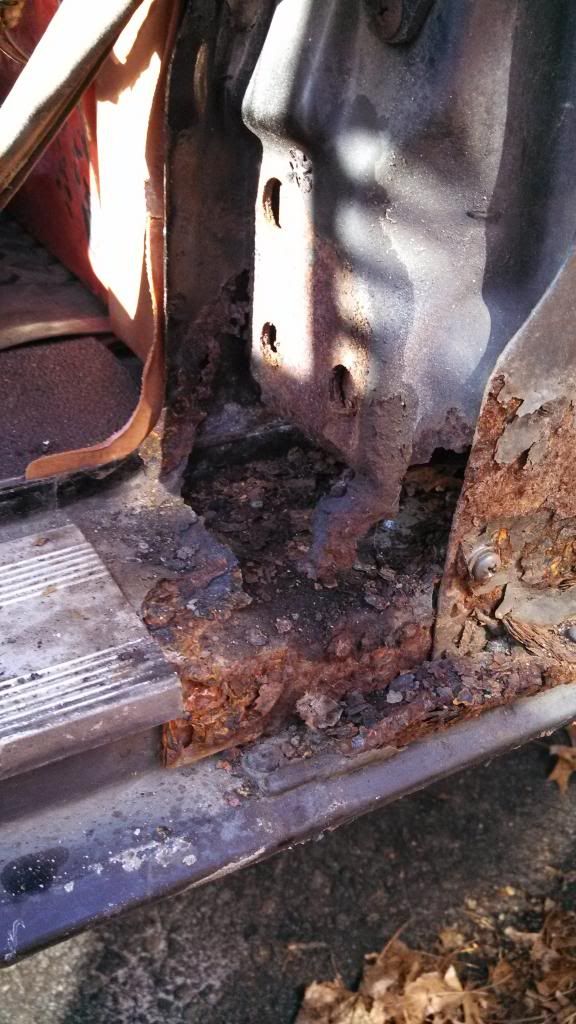

              • I addressed the rusted out bottom of the passenger side B-pillar, which looked like this:

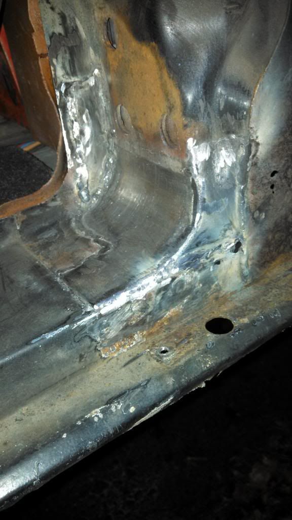

                After some cutting, wire brushing, sanding, painting, more cutting, hammering, welding, and grinding, it looked like this:
                Then I primed and painted it, and put the door back on. I already did the driver's side but that wasn't quite as bad. I drilled a 3/8" hole in the bottom of both pillars to help them drain, water easily gets in there and how Jeep neglected to put a big drain in there is beyond me. The blue Wagoneer is definitely getting drain holes there too because it has the sunroof with the drains going into the B-pillars!
