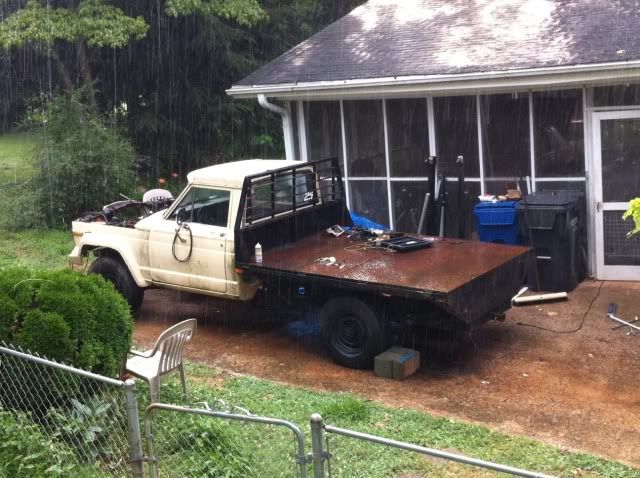

    The wife is pissed because I brought this J 20 home last month.
