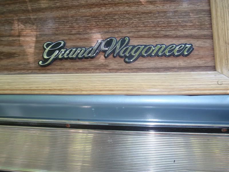

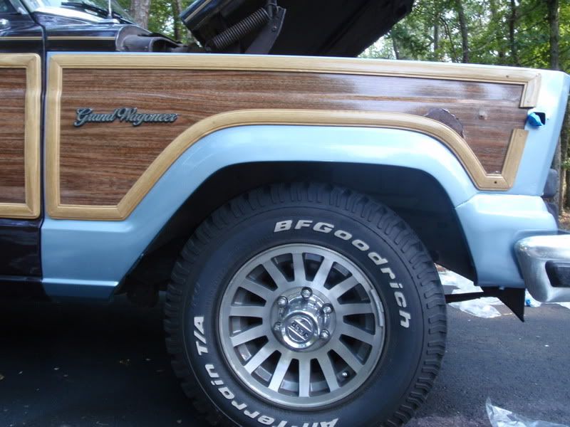

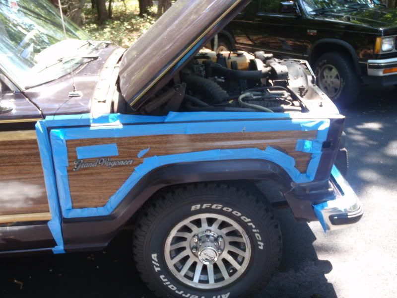

                • #38

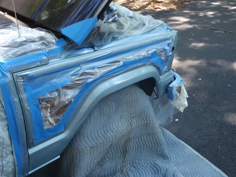

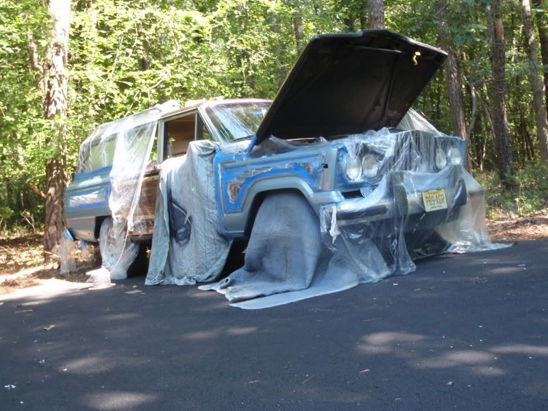

                  Update
                  Got some more painting finished on the Wag last night, here are a few pics as well as some Rustoleum hammered paint info
                  Quick Tailgate Shot/ New Favorite
                  [IMG][/IMG]
                  Raising the Gasket- now one step higher in quality over a certain autobody company
                  [IMG][/IMG]

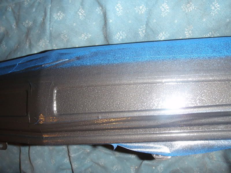

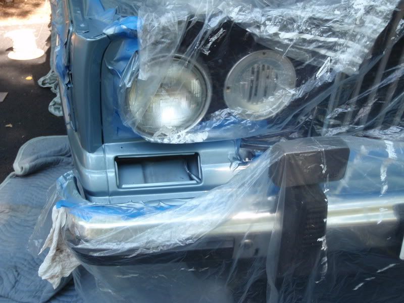

                  Some Taping- Gotta be more patient during this, found a few mistakes that led to touch-ups
                  [IMG][/IMG]
                  Mid Painting
                  [IMG][/IMG]
                  [IMG][/IMG]
                  [IMG][/IMG]

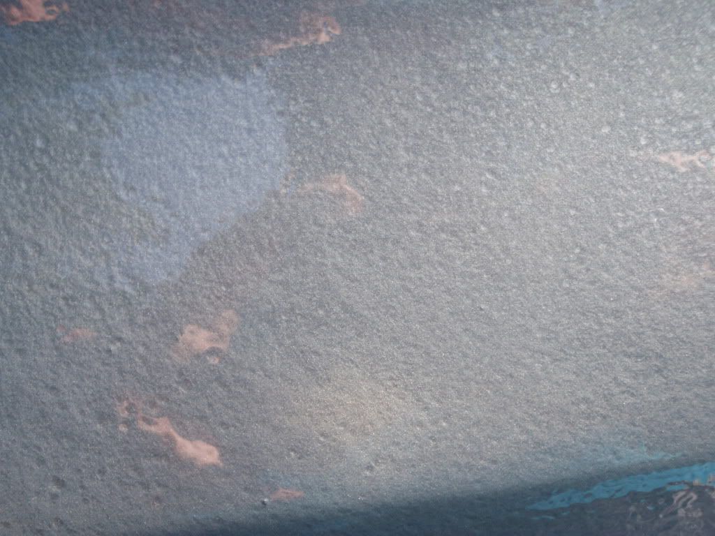

                  The Paint finish/texture
                  [IMG][/IMG]
                  Before Tape Removal
                  [IMG][/IMG]
                  De-taped
                  [IMG][/IMG]
                  [IMG][/IMG]
                  [IMG][/IMG]

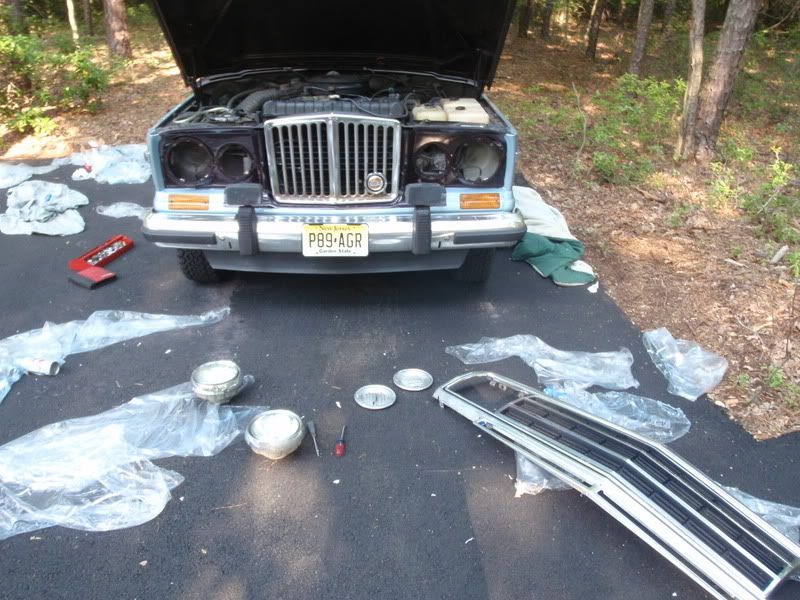

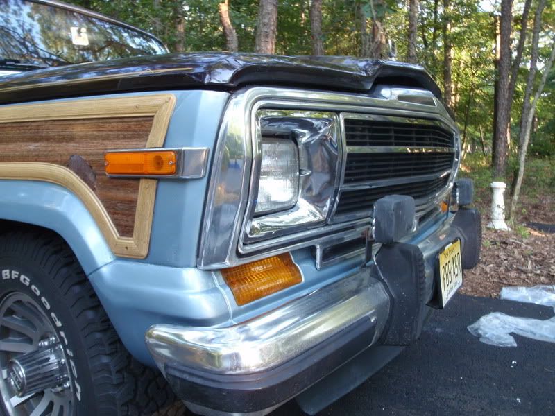

                  Back to the Original Grill
                  [IMG][/IMG]
                  [IMG][/IMG]
                  [IMG][/IMG]
                  [IMG][/IMG]
                  [IMG][/IMG]
                  [IMG][/IMG]
                  [IMG][/IMG]
                  Grill Detail
                  [IMG][/IMG]
                  Hammered Paint Write Up (long)
                  So far I love the color and the finish of the paint and with the wood panels I won't need to purchase so many spray cans. I will restate that i went this route for paint for a factory resemblance yet a more rugged looking truck for the woods that can easily get a quick touch-up. I went with the Spray since this color is not offered in quarts. I emailed Rustoleum and they stated they will look into it but I didn't want to wait. If I had to do it again I would of looked into a quart of the Deep green and went that route. The only issue besides a sore index fingered and a now well toned Forearm is finish consistency. With the hammered paint it needs a thick wet coat to give the most of the textured finish. But I don't wanna create anymore runs and drips in the paint that a certain Autobody shop already did. That is why i would go with quarts since I think a roller would be more consistent than a spray can. Available color for this finish in quarts that are similar to factory color is the Deep Green but the label online is probably not correct to true color. So far the paint looks good and is holding up well to the weather. No tests as far as durability has been conducted but have read that to get the finish Mica is added to the paint which is said to increase durability. Hopefully this information is helpful and useful.
                  Ask any Questions you have as far as the actual paint. But I am only 22 so I don't know as much as I hope to eventually learn.
                  1990 Stock for now Grand Wagoneer
                  U-993
                  Hey there Yohoo, fix yourself!!
                  My jeep
                  http://www.ifsja.org/forums/vb/showt...highlight=1990

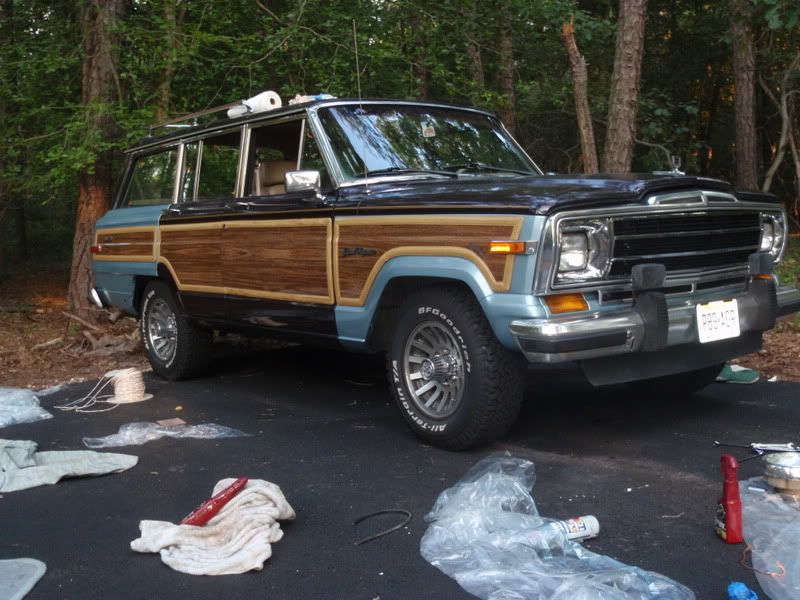

                  • #39

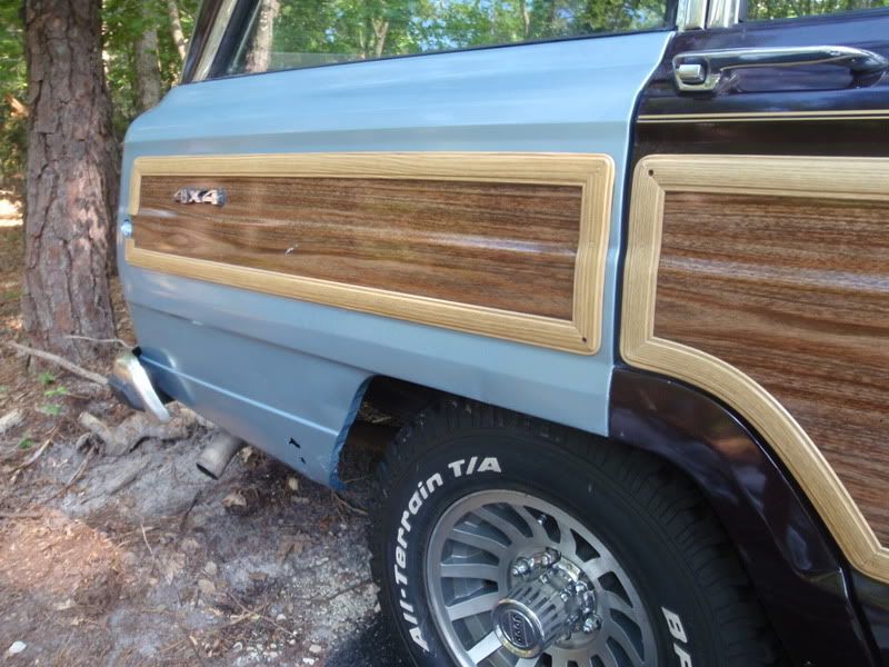

                    Getting Close
                    Painted the Drivers side doors and hood, got some buffing to do and such as well as painting the roof.
                    [IMG][/IMG]
                    [IMG][/IMG]

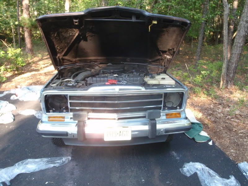

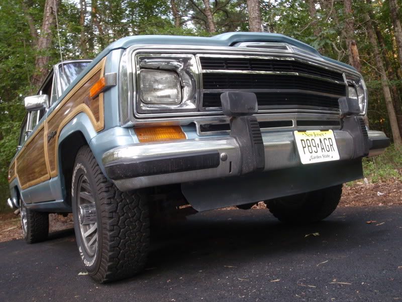

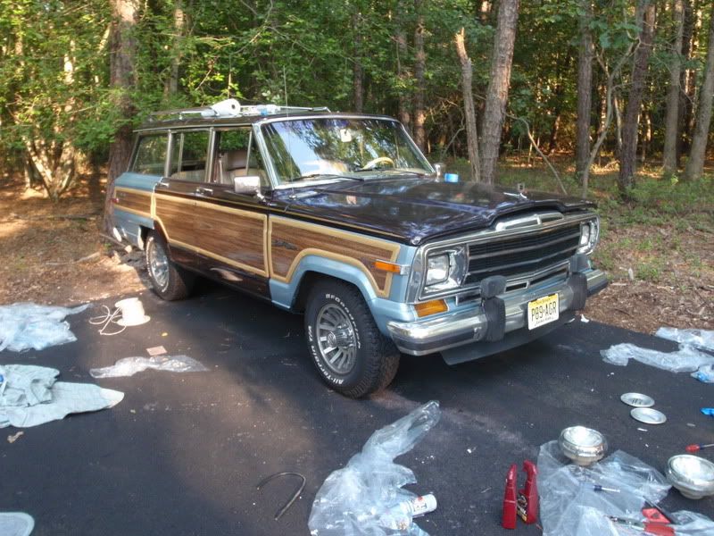

                            • #44

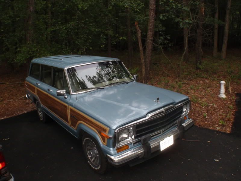

                              It's All Blue
                              It's official, the Jeep is all Blue, Now to just touch up some things and do some small details.
                              [IMG][/IMG]
                              [IMG][/IMG]
                              [IMG][/IMG]
                              [IMG][/IMG]
                              [IMG][/IMG]
                              Now just gotta buff the roof and it'll look complete
                              [IMG][/IMG]

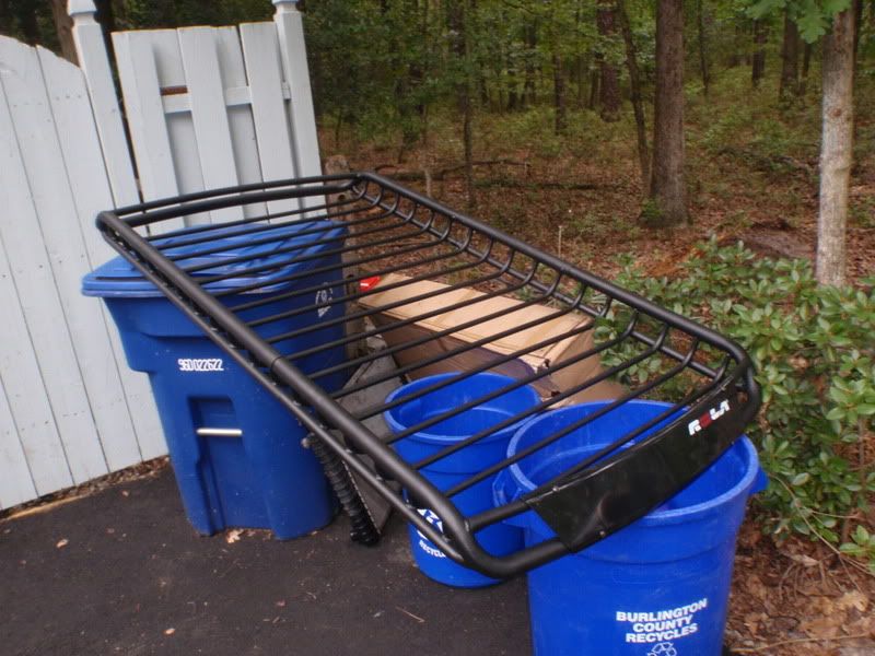

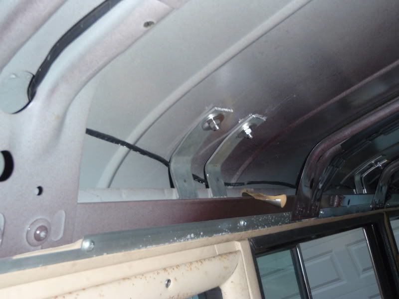

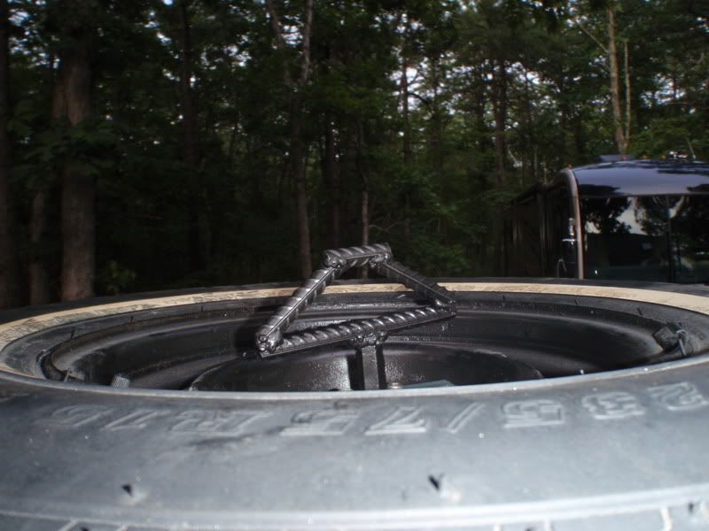

                              On another note, bought a roof basket, Remounted the factory roof rack and overhauled it to hopefully hold more weight, made a spare tire mount for the basket, drove to my aunts house and heard a rattle, got home and the actual rack was starting to fall apart
                              [IMG][/IMG]
                              Made small brackets to mount inside the roof, with these I could shake the whole truck without the roof flexing at all.
                              [IMG][/IMG]
                              [IMG][/IMG]
                              [IMG][/IMG]
                              [IMG][/IMG]
                              Now taking my brand new roof basket and cutting it in half and making it wider so that I can fab some mounts and make the basket a full replacement for the roof rack.
                              [IMG][/IMG]
                              Also bought an extension for the rack to make it the proper length in my eyes
                              Next in line after the roof rack is finished is a suspension overhaul. Thinking 4" lift springs, 1" block in the rear and 1" shackle in the front to run 5" of lift to fit 33x10.5 A/T tires, From reading I think they will rub while offroading but I don't plan on anything too crazy in the woods since it's my DD, mainly just some trail drives. Main reasoning for the lift is that the springs or beat and the shocks are close to gone, so i need new suspension anyway so why not get what I want now.

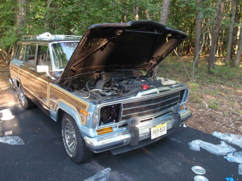

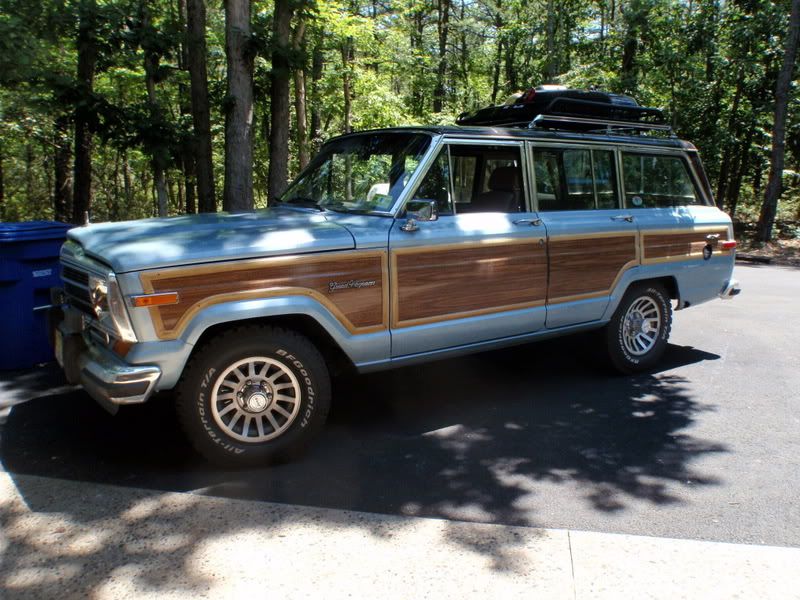

                              • #45
                                New Pic
                                Here's what my Jeep looks like now after some prep for the Jeep-In this weekend. mainly got my spare out of the cargo area and on he roof thanks to the help of my brother in fabbing up some mounts.
                                [IMG][/IMG]
