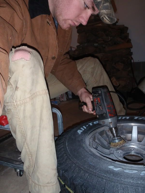

            The wheels took a total of 11hrs between the removal of the old paint and repainting and polishing the center caps and remounting them. I did it over winter break.

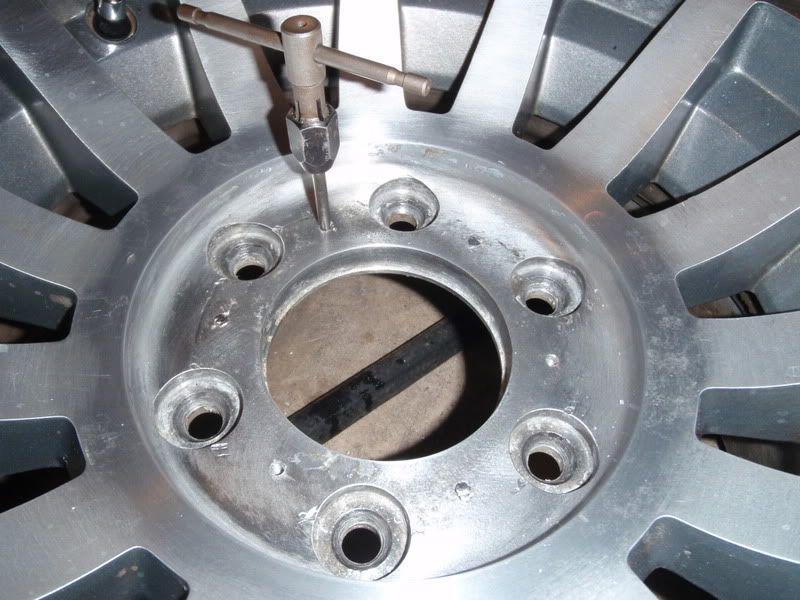

            Step 1: lightly use the brass wire wheel going with the machining of the wheel. Use no pressure and stay till the metal looks clean. If you push too hard the brass will start to cut the Aluminum and it won't look as good..... Wonder how I know that
            [IMG][/IMG]

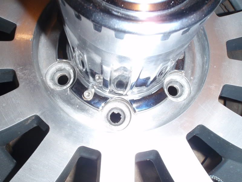

            Step 2: I mounted the center caps. All the screws were seized so I snapped them and clocked the center cap and made new holes and tapped them.
            [IMG][/IMG]
            Step 3: Then used 1/4 20 SS allen bolts to mount the center caps.

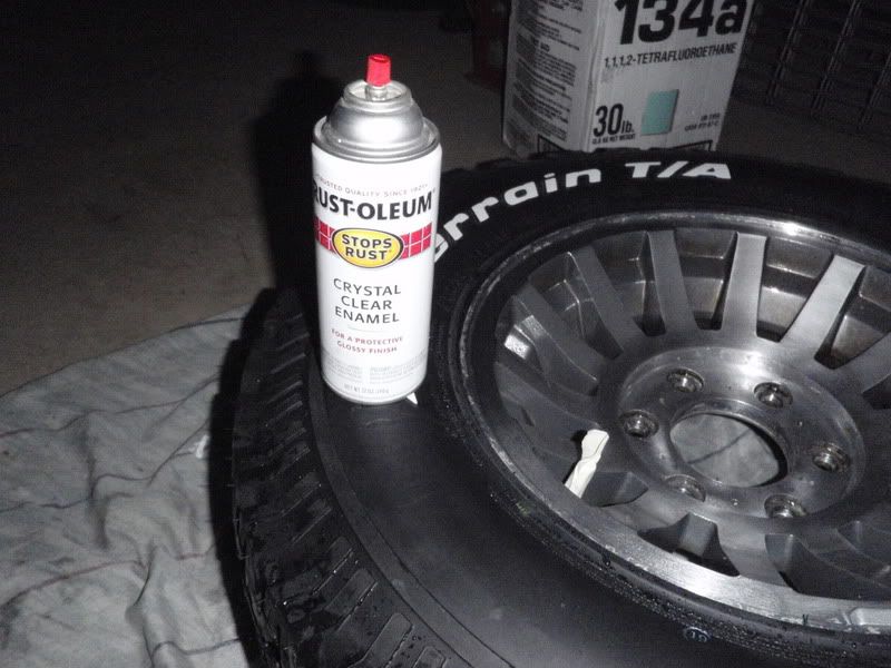

            Step 4: removed the center caps and sprayed with Rustoleum Crystal Clear Paint with two coats waiting one hour between coats. Let dry over night and then got the new tires.
            [IMG][/IMG]

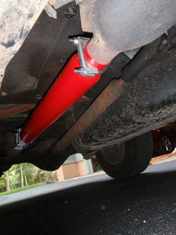

                      Quick Update

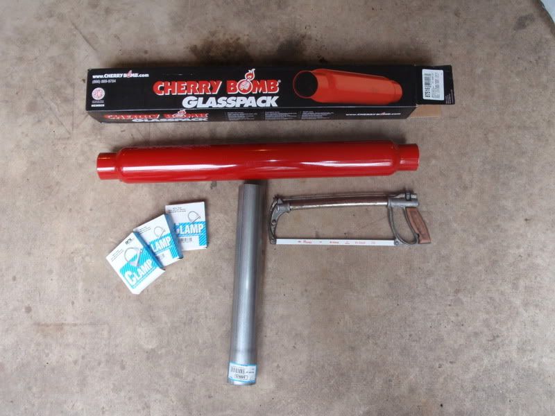

                      Decided to waster $40 and make my exhaust a bit louder. Have a few pics of what I used and two short videos to hear the difference.
                      Before Video
                      The Supplies
                      [IMG][/IMG]
                      Finished
                      [IMG][/IMG]
                      After Video

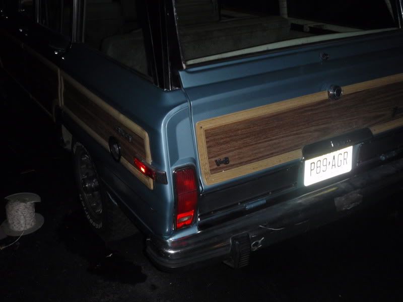

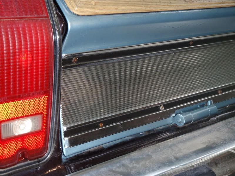

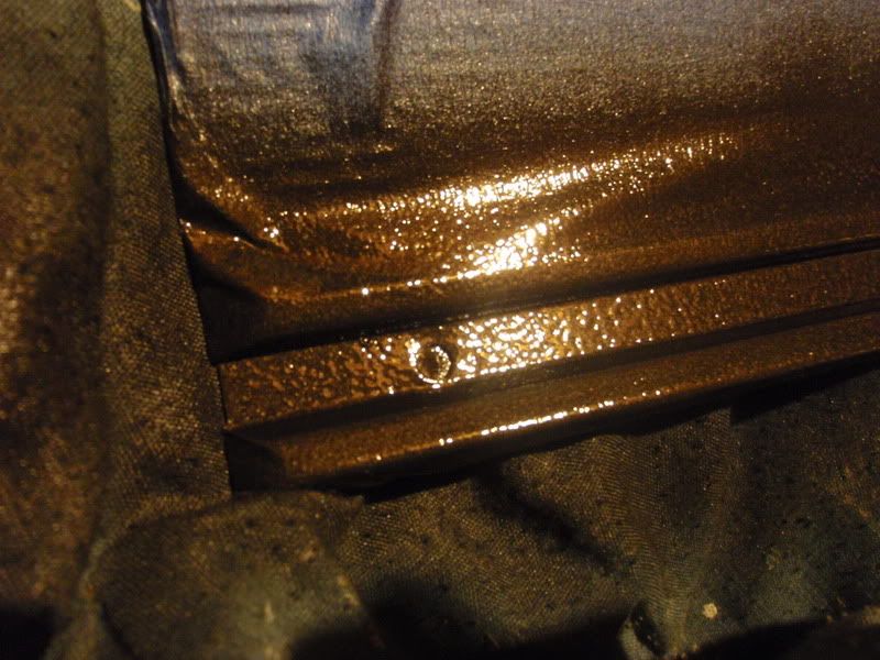

                        I decided I'm tired of my Maaco paint job, it's peeling at all edges and looks like crap, So i'm painting my truck and changing the color as I go. I'm painting the Wag, dubbed "Walter" by a friend, to light blue. I am using Rustoleum hammered paint, for a more durable finish as well as a more aggressive look. here are some pics
                        [IMG][/IMG]

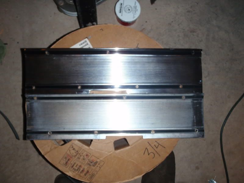

                        Cleaned up the rear trim as well
                        [IMG][/IMG]
                        [IMG][/IMG]
                        Need to refinish my screws
                        [IMG][/IMG]
                        [IMG][/IMG]

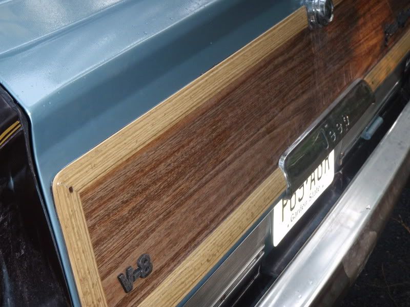

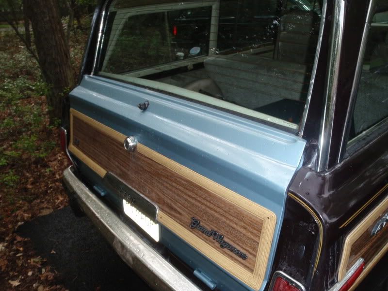

                            Is that just a rattle can paint job? looks pretty good, I can see a run on the gate but looks pretty darn good.
                            2000 WJ Grocery Getter and RC approved, 4'' Lift.
                            1983 Wagoneer Limted - Future tow rig
                            1988 Grand Wagoneer - All stock but super sexy and clean.
                            1989 6.2L Turbo diesel YJ, 6.5'' lift, 35's D44 F&R, SM465, NP205, Woody's shafts, Christmas tree air freshener.
                            • #29
                              Yep
                              Yeah it's a rattle job, The runs in the paint are from the Maaco job, spent three hours sanding the tailgate and it was still there Decided it was a rattle job so it won't be perfect anyway so i sprayed it. Slowly working around the truck one panel at a time masking everything off, sanding, and removing the trimmings. The bubbles in the one picture is because it rained an hour or so after I finished painting the tailgate, luckily it had no effect on the finish.
