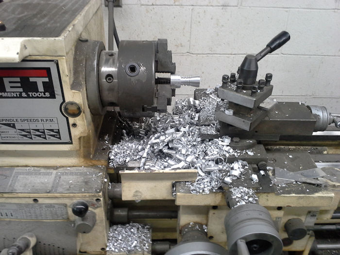

    I had a few moments of free time at work and started thinking about my antenna problem. So I did something about it.
    We have a big metal lathe at work, that I had never used before but got a quick lesson before the guy who knew how to use it retired and I thought I would put it to work. So I started with this.
    That's a big hunk of aluminum I bought to make a part for my wife's Mercedes but I only needed around a 3x3" piece of it so I have a lot left.
    So I took it and put the antenna nut on it to see how much I needed to cut off
    drew a circle around it
    and cut a big enough piece off that I could turn it down in the lathe to replicate the original nut

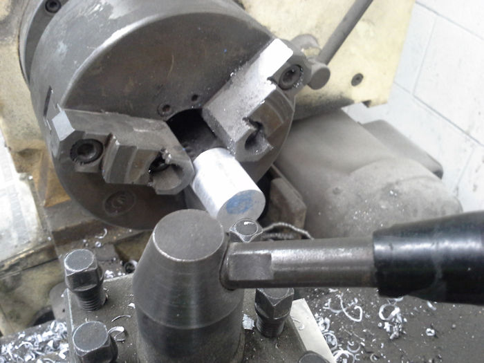

    I then chucked it into the lathe and tried to make a square peg fit a round hole
    and now I'm out of time and have to go to work Stay tuned for part 2 tonight or tomorrow

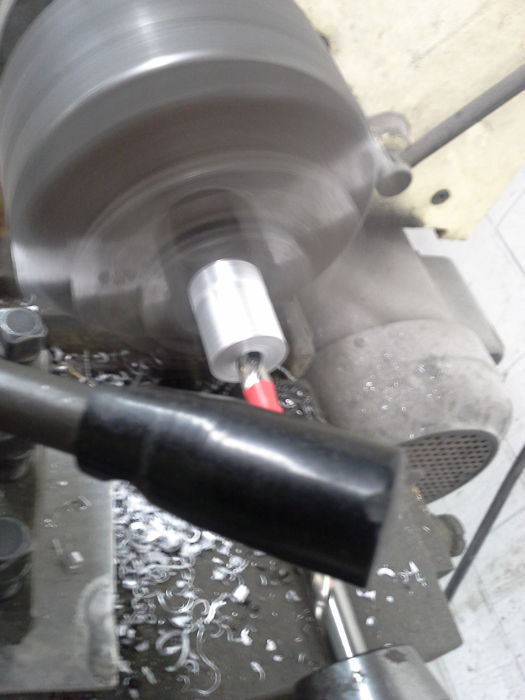

      • Once I had half of it turned down to round I then turned it around and turned down the other side
        I now had a piece of round stock which is where I could have started off if I had made a trip to metals supermarket but the big hunk-o-aluminum is what I had so it's what I used. It would have saved a lot of time though.
        I then drilled a hole in it
        Well, two really, first an undersized one that was all the way through then I enlarged it to 7/16" part way through for the purpose cutting the 1/2"x20 threads.

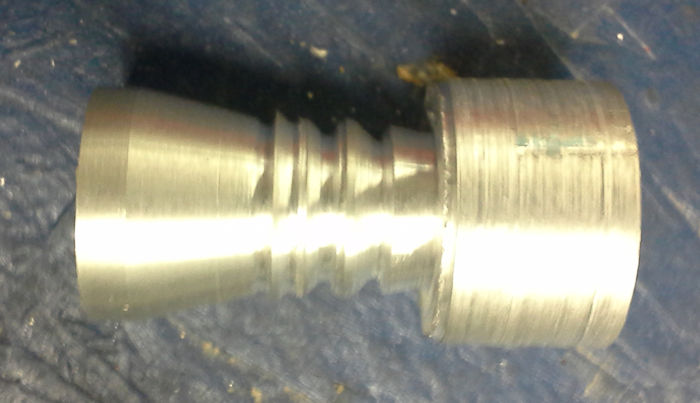

        Then I started shaping the piece with the intention of duplicating the original but as I was cutting I kind of started thinking something else. Then I made a mistake and gouged it beyond repair and had to start all over again, this time I used a longer piece.

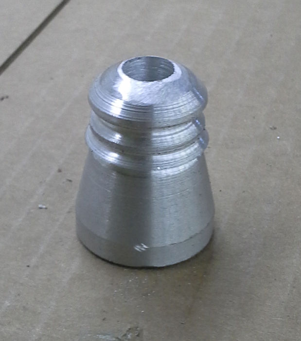

        So after cutting a new square piece, turning it down to round and drilling a hole I began playing with turning the new nut. Eventually I got to this
        Which I really liked but it still needed threaded and cut off.
        I thought I would also show you guys the aluminum I removed

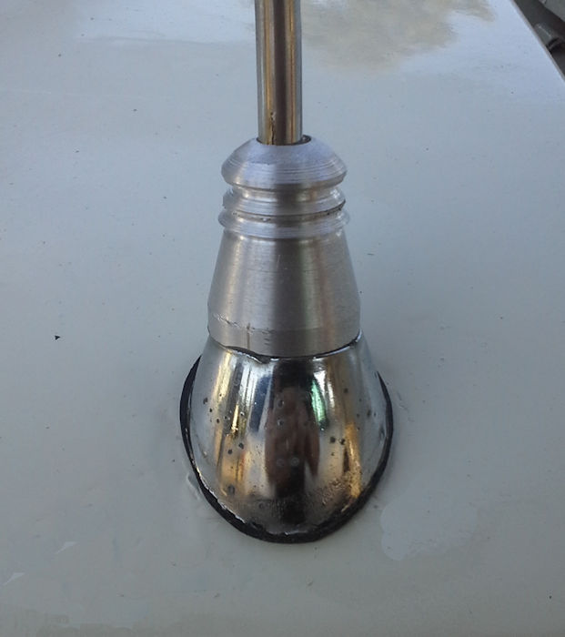

        Then I clamped the nut in a vice, modified the tap that I had modified into a bottoming tap so it was capable of starting threads again and I tapped threads into it. Then chucked it back into the lathe and cut it until it parted, then sanded it down to round the top.
        When I got home I threaded it onto the antenna and I really line the way it looks.
        Although I think it does kind of resemble a Dahlek from Dr Who

            Thank you.
            I know it's a little thing that really won't get noticed by anybody but I like it
            I will probably polish and clear coat it before it is permanently mounted.

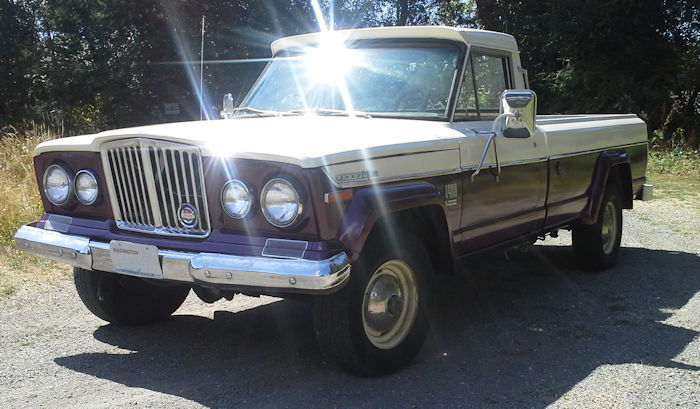

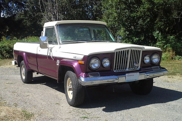

              • I haven't redone the fuel lines but I did get the front bumper installed. Thank you once again 78 WIDETRAC.
                and also found a nice place to take pictures
                I also noticed the other day that my brake lights didn't seem to be coming on except when I was stepping on them very hard so I replaced the brake light switch with a new Delco one and they seem to be working correctly now.
                Yesterday I finally got more bedliner in but haven't gotten it shot yet. Hopefully I will get that done on my next weekend.
                '72 J4500
                • Truck looks great with the bumper back on, loving the paint, glad to hear she's running good again!
                  Love the lathe work to solve the antenna issue

                  • Jour truck is looking very good!
                    Are the front bumpers bolted down correct?
                    They look like sticking up on the outer bent!?

                    • Originally posted by ddversatile
                      dd
                      Thank you
                      Thank you
                      They do turn up but the original bumper did too. If you look at the pictures on page one of this thread you can see it. Maybe the mounts are bent or something but looking at pictures on the internet it seems to be a fairly common thing. Some day I will probably try to straighten it, maybe shim it because it just doesn't look quite right and I don't think it would be too hard to fix, just a couple of tapered shims.
