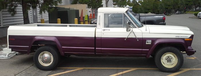

                  • The other day when the truck was at work I did a walk around photo shoot so I thought I would give you guys the experience. This also reminds me how much I love my truck.
                    '72 J4500
