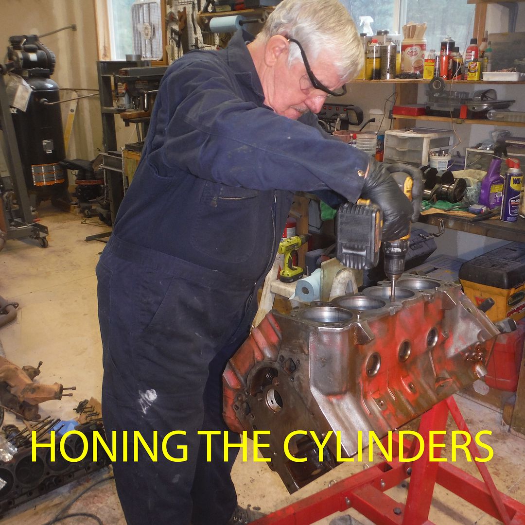

    Have new rings coming so I honed the cylinders out and for the most part look great. A couple of spots look okay but will work. New timing chain and sprockets also on the way. I found reman heads with hardened seat for right at $650 each here: https://www.jegs.com/c/Engines-Compo...10175/10002/-1

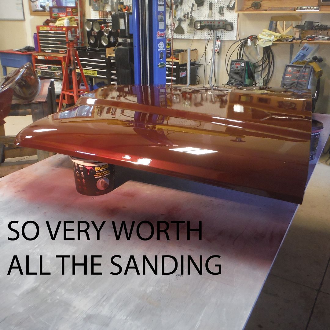

          • Frank that paint looks great!! I also love the picture of your dad and the German Shepherd hanging above your work bench, it like they are watching over your work.

            • Yes the paint is really cool. Love the color. You might read the reviews on ATK. I don't want to be a buzz kill Frank, but they have some pretty big issues. I just read up today looking for a Mercruiser boat motor long block.
