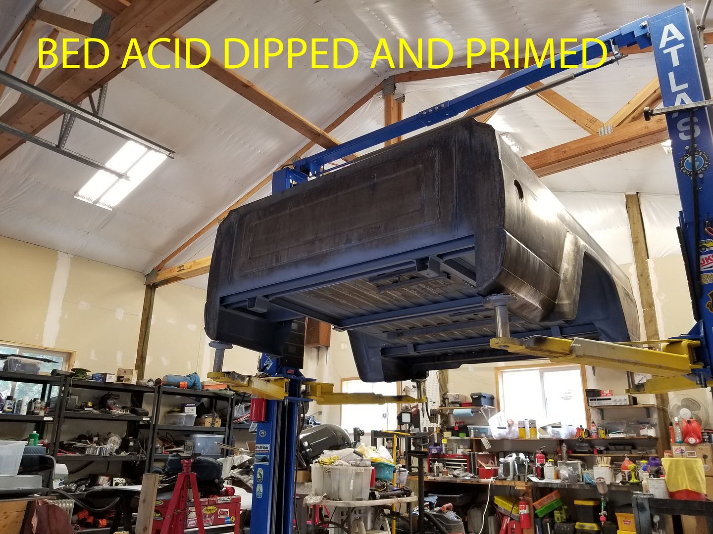

            To the subject: today I actually got back on the truck--kind of. Took the bed to get acid dipped. Decided to do that before any kind of body work so I could actually see the rust I want to replace.

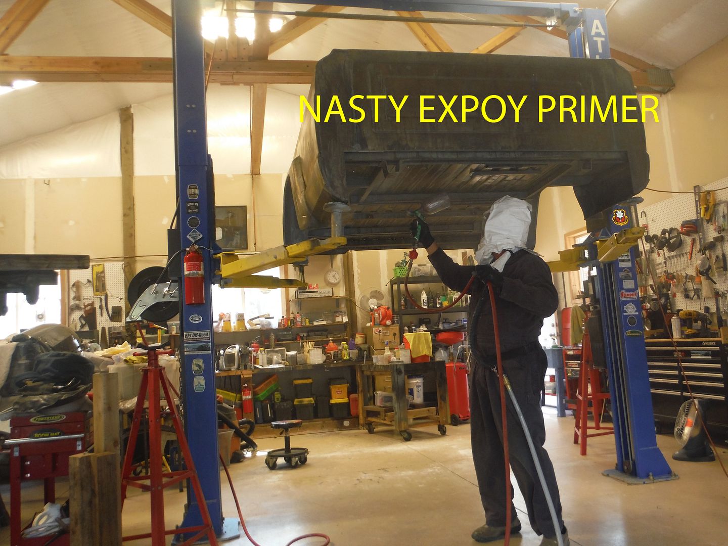

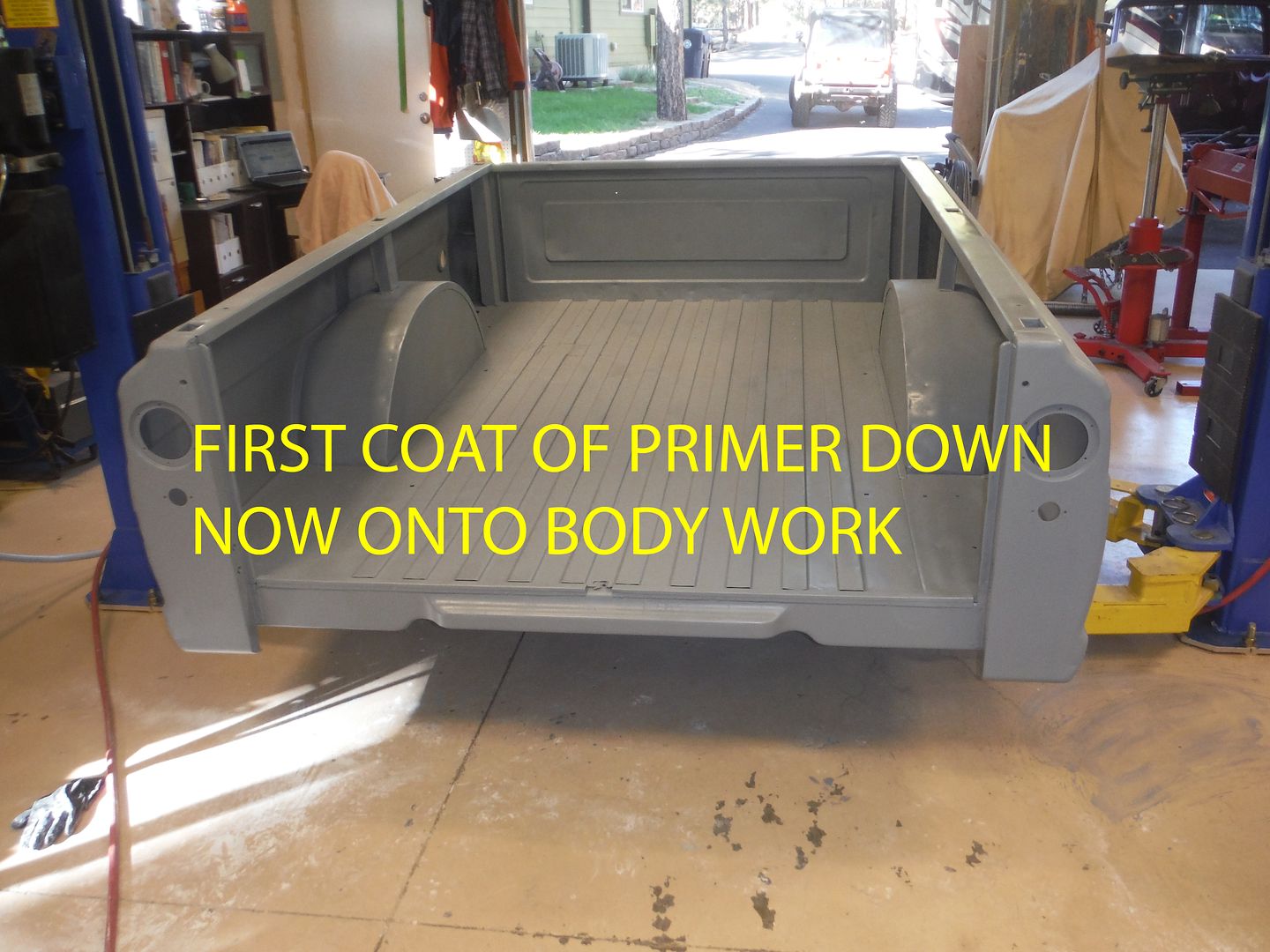

                  • Got the bed back from the dipper and shot a coat of "kill-you-if-you-breath-it" primer. Looked in pretty good shape until the primer showed all of the stuff that needs work. I foresee many hours of pounding and tapping and SANDING.

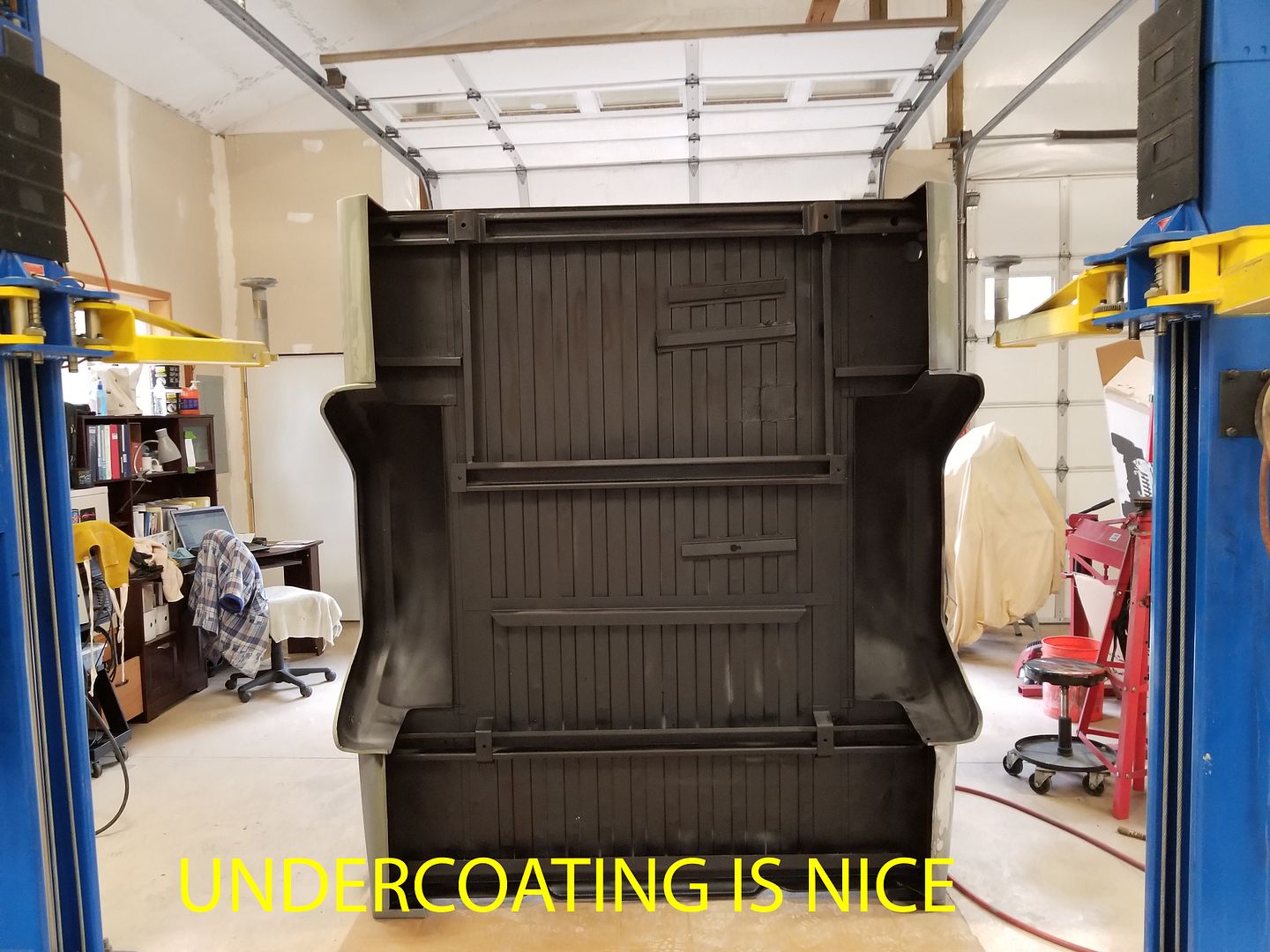

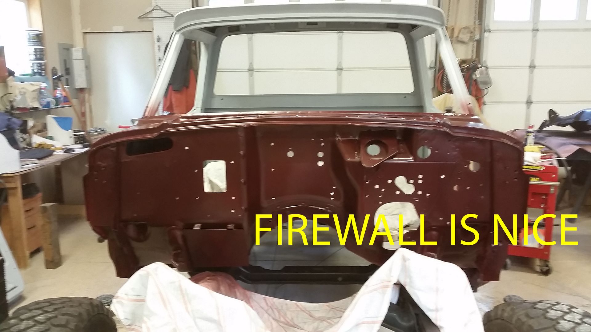

                    • Truck is back taking a break while we wheel in southern Utah. This is what I got done before we left.

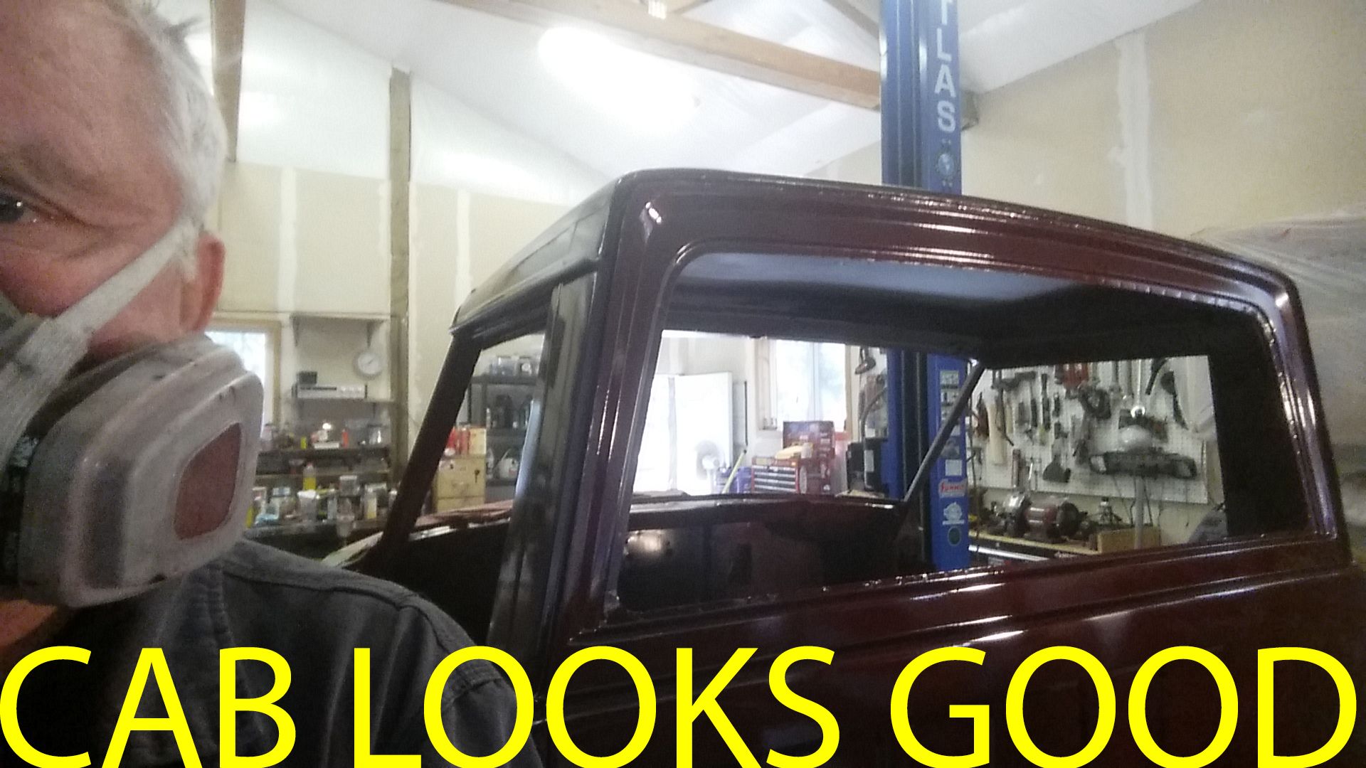

                        • Thanks Dave. Hope to shoot all the color in Dec or Jan. Then start on the motor.

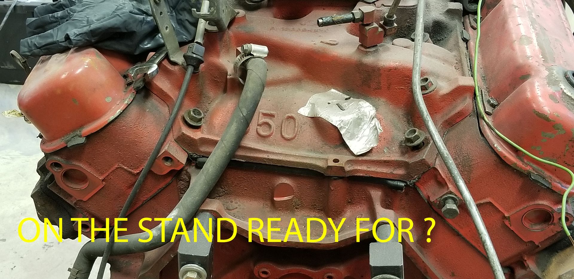

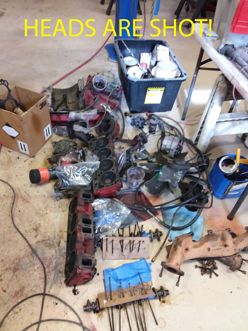

                            • Pictures may be duplicates. Trying to show a sequence here. starting on the engine so that I can get it landed before mounting the inner and outer fenders.
                              Progress

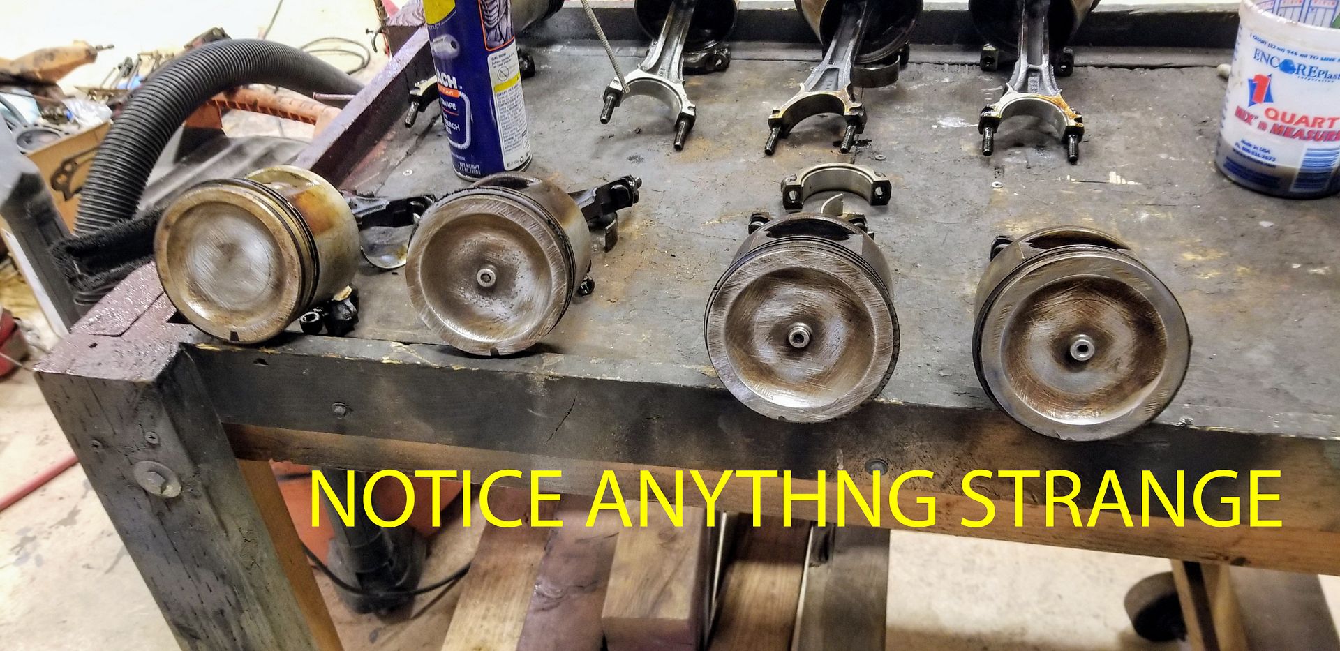

                              • Truck is looking great Frank. When we had our 350 rebuilt, we put in hardened valve seats for todays fuel, a roller chain and most importantly high zinc oil. I am about to do a post on the importance of Zinc in all our older motors.
                                There were also flat cam lobes in the motor here. Directly related to modern oils. How do yours look? Are you going to rebuild or replace?
