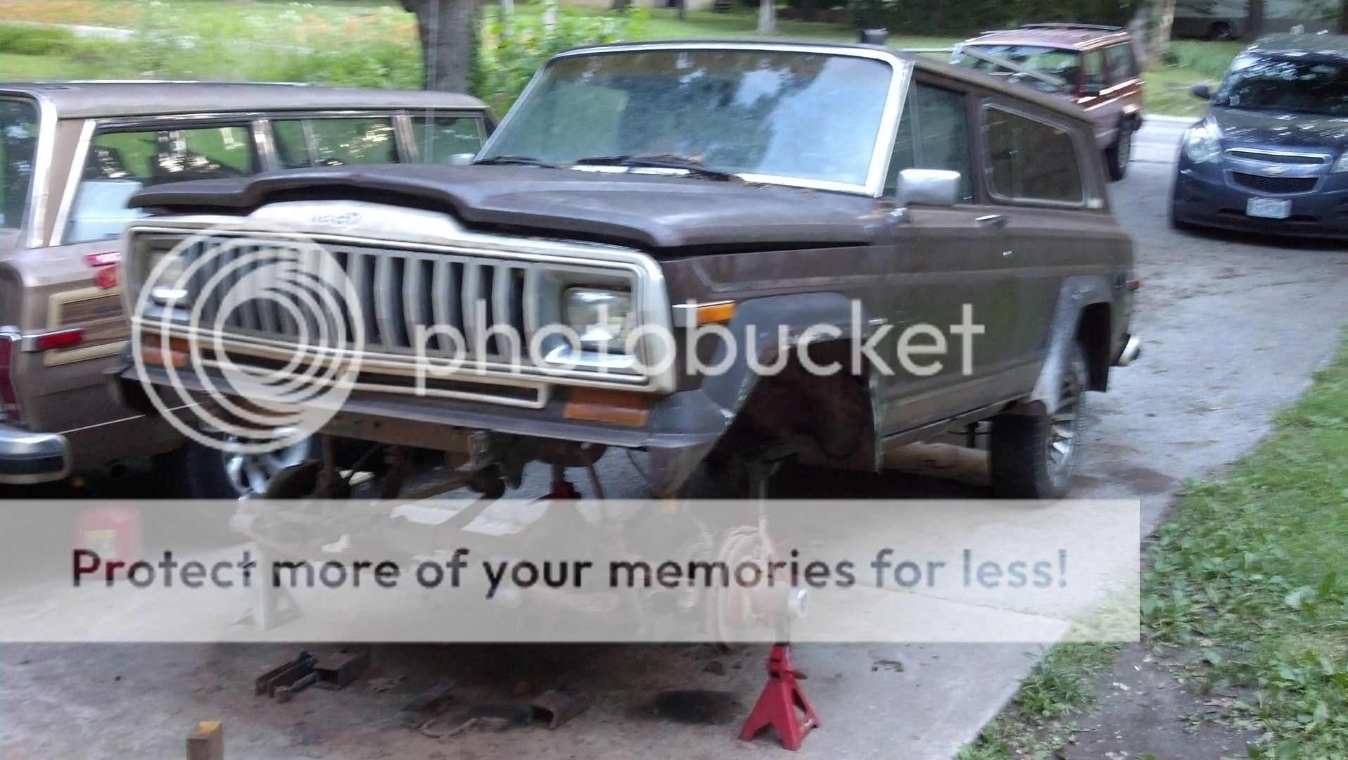

      The original plan was to use the Cape 82 as the donor vehicle for Power Train, Springs, Axles and other various pieces and scrap/sell the rest. The engine ran so strong, I felt it was the way to go... then I fired up the Hack Chero. SIXTY PSI even after warmed up, ran much smoother and quieter than the Cape Chero... lo and behold when I looked at it, it has obviously been rebuilt.
      So, I am taking everything but the engine from the Cape Chero and I think I already have that sold. During the wrench day, we hacked and burned the nasty lift and this is about where it sits now: (though the front axle is completely pulled out of the way now)
      This metal will come in good for SOMETHING... not a lift though! The giant rear lift blocks were made of SOLID STEEL and must weigh 25 pounds a piece! NASTY! (not shown as I was too tired to pick them up!)
