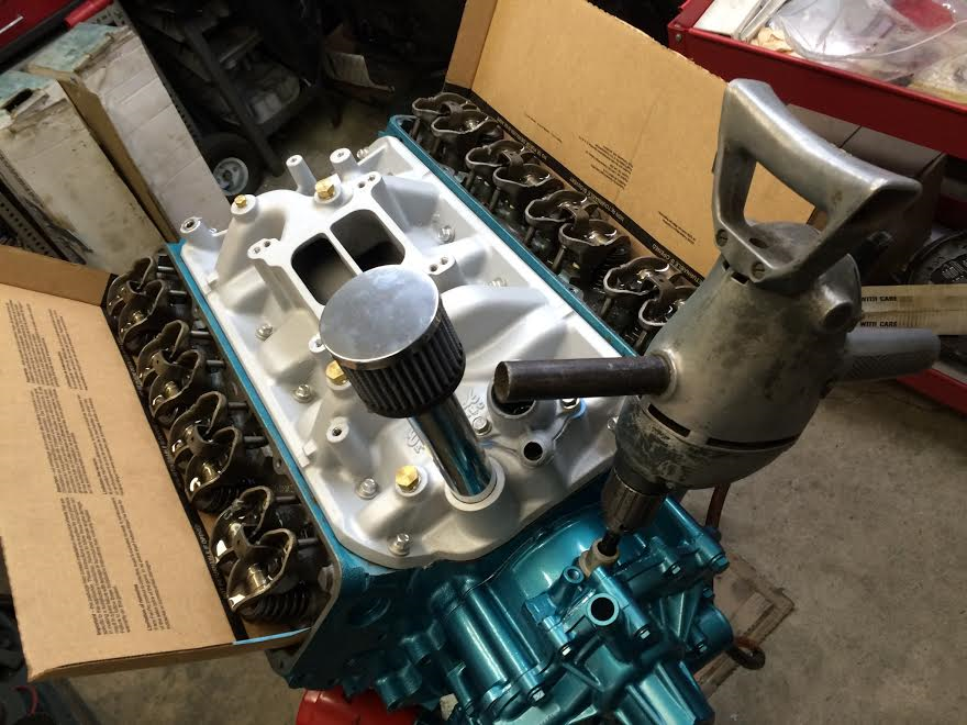

I Bolted the heads on and got a couple coats of paint on it last night. I like to paint them upside down first so that i get paint on the bottom edge of the heads and everywhere else that you can't get to when it is right side up.
