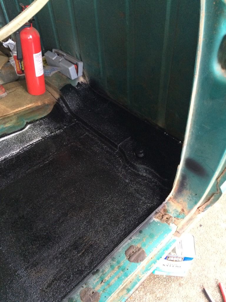

Driver side floor got sealed up yesterday and the first coat of truck bed liner got laid in today. All in all I'm pretty impressed with myself on this first welding job. Hoping the passenger side goes a little more quickly. Then I'll be rolling it in the garage and repairing the rust outs on the body. Wish me luck! More soon.

looks good! is that the pan I sent you?
Thanks man! And it is! I didn't know exactly how it was supposed to be oriented as I had so little usable sheet metal left once I cut all the nastiness out, so I'm assuming I got it right. It's the section from the kick panel about halfway back. It fit there like a glove though! By far one of the easiest fittings of any of the pieces to fit in that little puzzle... I'm starting on the passenger side tomorrow, very curious what I'll find there, a little afraid to be honest, hoping it's not as bad as the driver's side, but I also am pretty sure that it will be exactly that bad...

Is the bed liner smell lingering as it cures or is it dissipating? I am actually thinking about doing the same thing.
So far, the smell isn't nearly as bad as when I was applying it but is still pretty heavy. I suspect by the time I'm able to actually spend any time in the truck, it will have dissipated some more.
The good news is it's the first time I've been in the truck where it doesn't smell like rust and rat poo.

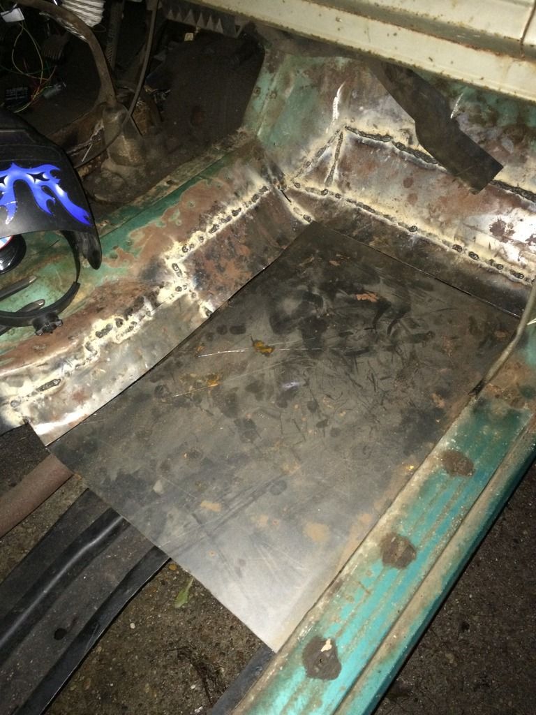

Progress continues.
Got most of the "metal" out of the passenger side today, it didn't fight me nearly as bad as the driver side. I don't know if that's just because I learned something from the driver side about the way the cab is put together or if the metal and all its spot welds were just in worse shape... I think I at least learned enough doing the driver side that now, when I get to cutting out my new floors from sheet metal will go a lot easier. I started with the big sections on the driver side, then used smaller pieces to fill in the corners, I'm doing it opposite this time, going to cut out pieces and do the edges first to hopefully move towards relatively flat square pieces at the center. Though be able to get a chunk of that done tomorrow. Did I mention I'm slow?
Also, it's been in the 90's in Baton Rouge this week with the humidity hovering around 60%. Yesterday, I mowed the front lawn, drank two big glasses of water then painted the driver side and still lost 8 lbs in water. Yikes. Fall cannot get here soon enough.
Here's what I had for "floors" to start on the passenger side:
Like I said, got most of it out with relatively straight edges to tack on to.
Out with the old, a little sad to see my road sign flooring go...
My newly formed flinstones floor after I ground and stripped the body supports as best I could and sprayed em with rust reformer.

So the rain is really not cooperating with me... Been raining for about 36 hours straight. Near where I live, my girlfriend's mom got 21" at her ranch. It's intense. Got the large front section of the pan cut out, laid in place, but I blew a fuse in my welder and my garage flooded (ask me how awesome it is to make sure that every single thing is off the ground in the garage.
Anyway, here are a couple pictures of the closing hole. Just need to drill out a body bolt access hole. It's so close I can taste it. Really wish this seen rain would go away.
Definitely learned to do better about cutting in straight lines to make my patch templates easier to make...
Also, this may be common knowledge, but I picked up the tip of laying duct tape over irregular shapes and more or less forming it to the shape you ultimately need, then using a razor to cut it at the existing metal edge and you have a near perfect template to lay down in the new sheet metal. Seems to work pretty well.
Here's what I've got left to cut out.
