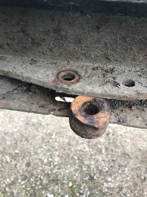

1979 Wagoneer... There's a spacer in a bracket that bolts to both left and right sides of the frame. The tow package was bolted through it. Is this bracket necessary if this hitch is not reused? If it is necessary structurally for the frame should I replace the pitted metal spacer?

It is only for the hitch, the brackets & spacers would not be used unless reusing the hitch.

If you decide to not re-use the hitch, you might be able to sell that bracket and it's spacers. The hitches are easy to find and cheap but for some reason, finding that bracket and spacer can be a bit tougher.
You would probably have to ask that builder what they mean by that. I assume they mean they lay the frame out on a rack and make sure all measurements are to factory tolerances for squareness and there is no rust/Damage. If you look in the 1979 factory service manual, on page 3F-2, you will see a chassis diagram with all the measurements I am talking about.
https://oljeep.com/edge_parts_man.html
Oh man, I thought I was going to get big bucks for my hitch. I do have the reinforcements shown above.

Anyway, rang-a-stang, I am building a pile of parts that will not go back on the waggy. Luggage rack for sure. Eliminating chrome and I have a Con-Ferr to replace it.
My guess on the brackets and spacers is that people neglect to remove the brackets and the spacers rust away. Mine are super pitted.
The brackets will be made available as soon as I have the Cliffhanger bumper in hand. I read that it does not bolt up to the stock bumper brackets.
My guess is that they are super rare. I have/had more than 40 Wagoneers and Cherokees over as many years and I have never seen frame brackets like those.
