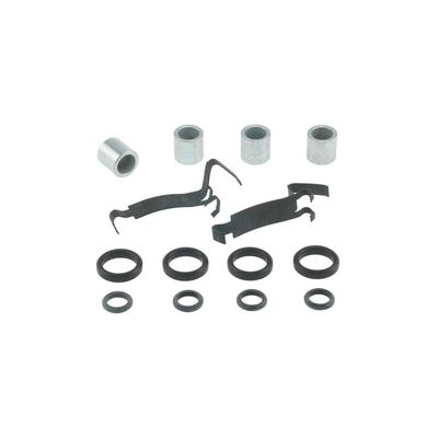

All GM type calipers (should) have them installed inside each caliper casting "ear" they surround the pin holes.
A big one and a little one per caliper.
Almost nobody knows they exist or ever replaces them!
They should be lubed w/ good brake grease as well.
They're a consumable anytime a brake job is done should be replaced.
Any autoparts store will have kits that include them.

At Autozone: Duralast Brake Disc Hardware Kit H5500, $4.19.
