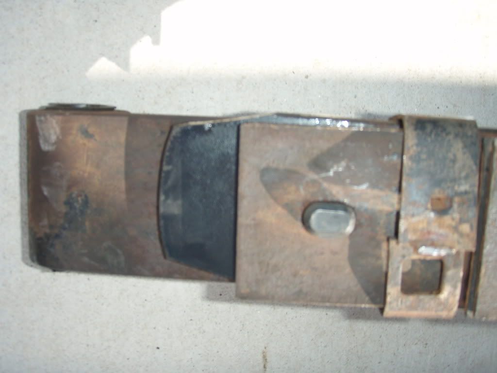

I have the Front and Rears here at the house and they are indeed full length. They are almost as long as the main leaf and actually install between the main leaf and the second leaf making them a true full length.

Would it be possible for you to post pictures? The main leaf is where the problem is at, not enough support. Thanks for the response.

Here ya go. I would order 4 more spring clamps as each set of AAL's only come with one and out springs have 3 installed.

Awesome thanks.
