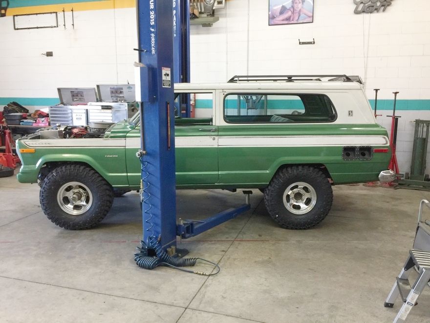

New tires and wheels. I might need a tad more lift. Too bad the front wheels hit the steering. I thought they would fit but they don't. 4.5" BS on a 15x8 wheel in case anyone is wondering. I'm having a local company custom make a wheel spacer for the front only. Should have those in an hour or so.
