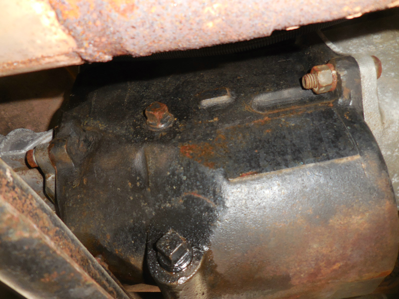

Also I have another issue with that tranny you might be able to chirp in on, There seems to be no fill hole for the lube in it. I have cleaned it and inspected for the plug but where it's supposed to be there is nothing....well, sort of nothing.
There is a circle in the case like maybe a plug but is flush. I am used to seeing a plug with a protruding square piece for a wrench or Cresent wrench to fit on to -OR- a recessed square hole for a rachet to fit into.
So I have no way to check fluid level. Since I wasn't sure how much was in it I dumped a quart in through the shifter cover after I removed it.....That may have done more harm than good. I was thinking it would drain down into the case but I might just be a moron......

Adding oil from the top won't hurt anything. That's the easy way to fill it if you have the top off. You should be able to see the fill plug from the inside of the case above. As Rocklaurence says, there has to be both a drain and fill plug. I don't have a good picture. Predicted to be sunny tomorrow; I'll crawl under my truck and see if I can show you better where they are.

I know what they look like and WHERE they are supposed to be from pictures but mine don't have one...
Unless it was the kind with a square sticking out for a wrench and it snapped off flush but I dont think that would be possible?

Passenger side.
