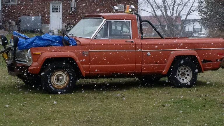

Finally figured out how to post a photo!
[IMG][/IMG]

Looks like the white stuff is already there.

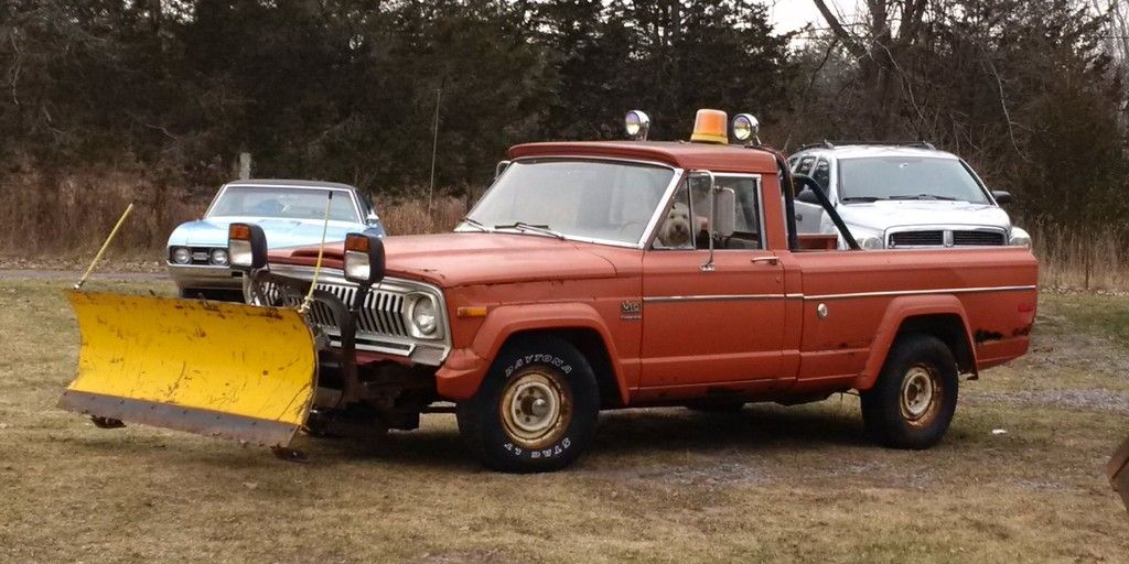

Running and waiting
Supposed to get our first real snowfall tonight. Got the Brakes done, plow mounted, tire fixed, lights wired, mirrors installed and am ready to go!
[IMG]http://www.ifsja.org/forums/vb/[/IMG]
