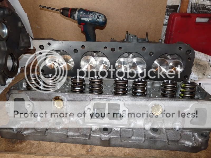

rebuilt heads.bowls cut for the AMX/SS oversize stainless valves. 2.08in 1.74ex.
Hey! Those kind of look like the heads you just gave me...whats the difference between the 2? Thanks by the way for the other parts today
