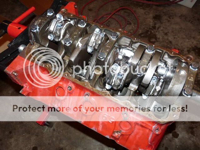

pulled the motor out of the GW to put the fresh tranny in,and to find an evasive oil leak,and put the baffle on the bottom of the intake manifold. i also decided to pull the heads and see how the cylinders were looking.
looks like the pistons were a little tight in the bores to me.
those scores can be seen but not felt. but the oil film barrier was definitely broken. 180 degrees from the pin,looks like it got tight right below the rings.
oh,found the leak too. the plug on the right.
will be loading this up later today and swinging by the machine shop for a visit tomorrow.

Man, that sucks! So how does that happen? Too hot? And what does one do to prevent it from happening again?

well....i think it's a compound problem.
i sent the pistons back to wiseco,they wanted a look at them. no signs of heat,however the pistons were spec'd incorrectly by the rather well known speed shop that "built" the kit for me. that same guy bailed on me when i got the pistons and found they were built to the early block deck height. he said it was between me and wiseco now. cost me a couple hundred to deck the block/plane the manifold. great customer service.
turns out,he spec'd a 360 piston with a 1" pin and the custom-(incorrect)- deck height. he should have discussed what my intentions were,which i covered in great detail,because Wiseco would have instead used thier standard 401 forging,and turned it down to my bore. the 401 has a rather severe rod angle. the 401 forging they use is a different alloy,and barrel shape to combat the scuffing these engines are prone to.
however,i don't think that was THE issue. the scuffing-polishing really,the markings couldn't be felt-was very inconsistent. i think what really did it was one of the mornings last winter when it was -28 degrees out,my coolant was froze up,too thick for the waterpump to push through. the engine would build up heat till it finally pushed through,at which time the engine would return to normal temp. i would have been inside drinking coffee while this was happening.
block has a fresh hone. fresh crank,bearings,rings. going to advance the cam this time too. using Hastings rings this time too,my preferred brand.

I'm just learning about inner engine problems, terminology and pretty much anything to do with the rotating assembly. I can see where you've pointed out the issue with the scoring on the piston wall and *I think* I understand what you mean when saying it's perpendicular to the wrist pin.
Is there anything else obvious in the photos that show other problems? I'm just curious. Does the fact that the oil barrier was broken only apply to the scoring on the piston wall or does that refer to the lighter-colored markings on the center of the piston too?

the oil film barrier refers to the cylinder/skirt scuffing. the markings on the top of the piston are from combustion.
that is where pistons scuff first when they get tight,for whatever reason.it is the largest diameter area.
