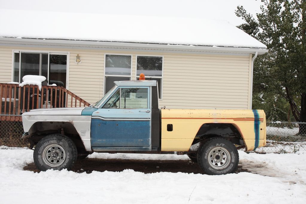

I DID upload a single pic showing the stock manifold being ported and not, side by side:

Pretty funny, that last picture is the same as the first one posted in the thread. Someday I would like to make a a A vs B dyno pull to learn the difference between ported exhaust manifolds and non-ported one on a mild street engine.

That would be interesting. I always though the steps would kill flow...but maybe its not as much as I think it is.
I did my "porting" job in September 2004, IIRC. That's when my blue J20 was getting roadworthy and I had to take the cracked Thorley's off. Here's the 1979 Blue J20 after it was road worthy...
Just recently repaired /modded those old Thorleys...
Here's the cross-bar/extended head flange inserts I made and welded on...
... and I finished a full length dual 2.5" exhaust system ( too many pics to post all of them here) but here's the crossover...
...mounted on the same truck but with different motor, tranny, T-case, bed, outer front clip, frame length, and axles...so not really the same truck except for the VIN.
The blue 1979 J20 truck before getting tires and a green paintjob....
