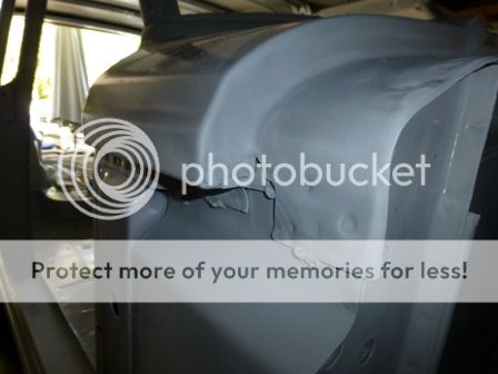

Got the body primed with epoxy, need to do the seam sealer.
There were some places on the cowl with more big blobs of the hard filler. I put in some patches to allow use of flexible sealer.
I decided not to seal the lower edge of these. Seems to me they should allow drainage or water could puddle. The openings only enter the cowl; not the interior.

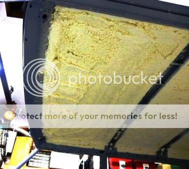

Sprayed the two part urethane foam on the roof.
Trimmed it to the crossmembers. Need to add a little more here and there. It ended up about ¾” thick in the two center areas.
The front and rear area have room for more since the headliner sits on the structure above the windshield and tailgate and slopes to the nearest crossmember. Also plan to fill the hollow members at the front, back and sides.
It really does take the “bong” out of the roof in those areas; not so much in the center sections where its thinner. I think they are better but it’s hard to say for sure. The camera didn’t save the before recordings. Don’t know if the camera mic would have been good enough anyway.
If I were to do it again I think I’d put up some CLD strips first.

The foam is an interesting idea.. I pulled some support beams out of a jy saggy that I will add to my roof to get some extra support. Might be an idea to add support to the larger sections of roof..

I would have left the gapping holes open there, easier for leaves and crap to be flushed out of the cowl, X2 on not sealing drain holes.
Looking good though, nice job on the roof and suspension.

Never thought of running spray foam in my cab. Always figured it would stink like crazy everytime it got hot.

Those holes were "sealed" by the factory and I was just looking for a better way to do it than some form of bondo like the factory used. After thinking about it I decided not to seal them. Leaving them open probably would have been better. I can always remove them if junk appears to be building up on them.
I find it appalling the number and size of holes Jeep just plugged up with various types of filler/sealer. There are some inside the cowl that will leak into the cab, some on the edges of the firewall, the ones already mentioned at the top of the A pillar, the top corners of the windshield, etc, etc.
Maybe other cars were built like this and I just never got into them in this much detail.

Won't the foam release formaldehyde gas in the hot sun? That's why it was stopped for houses.
Old 02-24-2015, 01:34 PM
SJTD SJTD is offline
Join Date: Apr 26, 2012
Posts: 1,525
Hope not. This stuff is supposed to be used in house walls.

Is it UFFI or Icynene Spray Foam Insulation? There is a huge difference in the outgassing. UFFI is only allowed in some places for crack sealing.
Old 02-25-2015, 09:19 AM
Posts: 1,525
  • Versi-Foam® does not contain any urea formaldehyde, VOC's, CFC's or Penta-BDE's. The use of proper Personal Protective Equipment (PPE) is required during application. Please see the MSDS and Operating Instructions for PPE guidelines.
Being urethane it does use isocyanate hardener.
