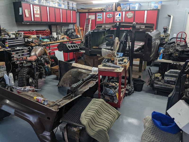

I FINALLY FOUND A PAINT/BODY GUY!! For the better part of a year I have been trying to find someone that will work with me on doing body work and painting Jo. In the very beginning I had looked at a local MAACO shop that was highly reviewed. I know what you are thinking, cheap paint jobs. BUT, after reading all the reviews and talking with the guy, he does not do cheap. After looking everything over, he quote me $6k if I brought him the bare body ready to be worked on. At the time that was over half my budget and I kept searching. During that car show I had taken Jo to, one of the classic car paint guys had come over and given me his card. I had filed it away and didn’t think twice about it. One day, when I had some time, I ran down there. Guy has a shop in his back yard and all he does is classic vehicles. After he looked it over, he gave me a quote of $10k, if I did all the prep work… At this point I was seriously entertaining just doing the whole damn thing myself. Fast forward to now, I had made acquaintances with a guy that owns a Jurassic Park Jeep replica locally and we got to talking about his paint. He found a local guy that also paints stuff in his back yard as a side business. Catch is, he only does movie cars and vehicles he finds interesting. This is the JP Jeep in question.
I went out to see it in person and the paint is flawless. He said the process was hassle free and he just paid as he went. At that point, I made an appointment to go meet the painter. Turns out, he has a J2000 in the backyard, pretty much the same truck. We went over everything and he agreed to do the entire truck, bodywork and all for $5k. It was a hell of a deal.
Not too much longer after that, Jo’s electrical system had had enough. Wires were constantly melting, fuses blowing, battery not charging, lights not working…. It was time. I pulled her in the driveway and shut her off for the last time.
I began the tear down that weekend. I managed to get all of the bolt ons and the bulk of the interior out in practically no time at all.
A couple of weekends later, my buddy Lee came over and we got the front clip and bed off. I managed to capture a time lapse video on this one.
Front clip and bed removal -> https://www.youtube.com/watch?v=zCZGFdLdPug&t=1s
By the end of Saturday, we were left with this. Just looking at it…I think it would be kinda cool to drive it around like this.
The next day he came back over and we got the drivetrain out.
Drivetrain removal -> https://www.youtube.com/watch?v=9NRGiAEF6NE
Garage is getting really full.
