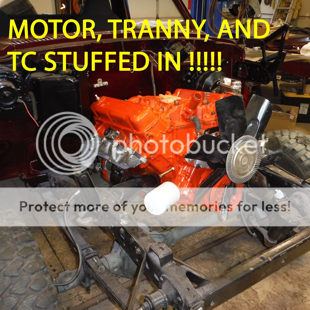

Been too busy and sick to post much lately. Doesn't mean progress has stalled.In fact, I have started rebuilding the dash pad with 3M Flexable epoxy.
I picked up the repaired head, mounted it and when trying to install the intake manifold found that the threads in the head for the intake manifold were gone. Not stripped, just rusted off. So a helicoil repair doen to 3 holes in the Rockauto head and one in my rebuilut head When i got that all done i reinstalled the manifold but Didnt get the bolts to 50 # of torque. Every tightened something knowing that one more fraction of a trun was going to strip a thread? Well i got 40+ of torque but stopped at that point.
A couple of days ago I used the shop crane to put the tranny and TC onto my moveable workbench. Many hours of spray cleaner and it was as clean as i was going to get it.
This morning I chopped the handle off a 8" screwdriver, slid a piece of fuel line over the end and chucked it into my drill. I used that to go into the distributor hole. I slid the fuel line piece down over the oil pump shaft to hold the blade in the slot and primed the engine. Reminder to self--put the pressure sensor into the block before doing this.
I then hooked up the shop crane and pulled the engine off the engine stand and moved the engine next to the workbench. From there it was simple to align the engine and tranny. Sorry no pictures of that--I was busy.
Then I moved everything into place and stuffed that bad boy combo back into truck. Tomorrow I should be able to get all the stuff mounted and secured.

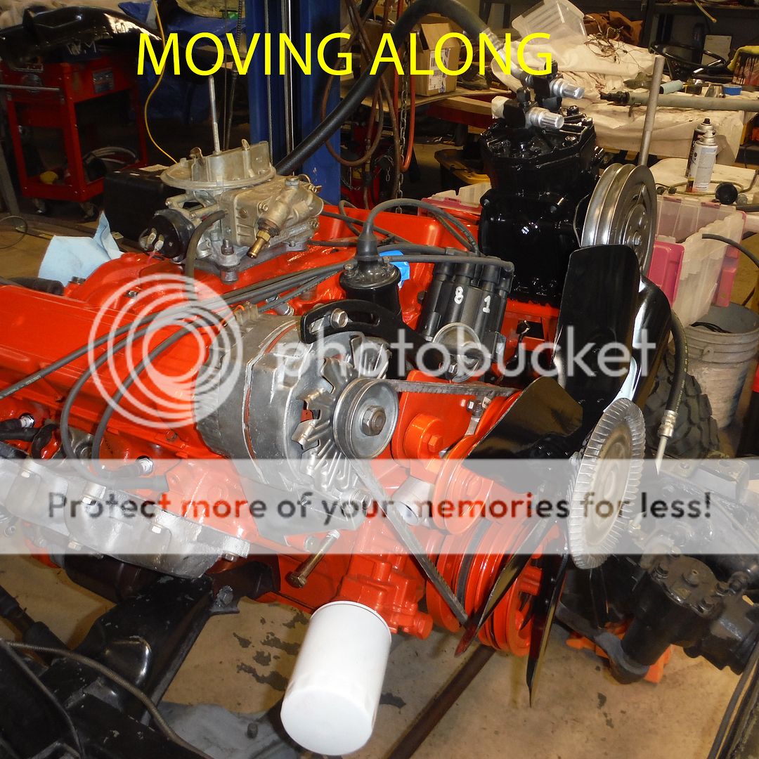

Things are moving along. Not nearly as fast as I'd like but still forward.
Rebuilding the entire steering column and part of that was fixing the cracks in the wheel then repainting.
I have the engine in the frame after pulling the cab back off for ease of access. I have new transmission mounts and torque arm stud with bushings. Don't have pictures of this mess when I pulled it apart. One of those hell I can remember this--but almost 3 years later I don't remember.
See what I mean?
This is what I mean by making progress.
