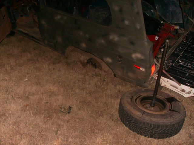

Yikes, I never seen those pics of the shaft coming out. As a driver who suffered from shaft removal, GET IT FIXED NOW!
If you can't find Timken Set10 bearings, National part #A-10 will work just fine.
