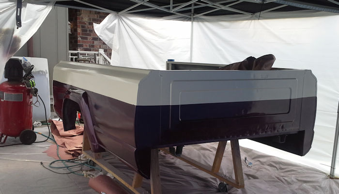

The other day I set to work putting up the make shift paint booth so it would be ready when I found the time to paint. It consists of two 10'x15' pop up awnings tiewrapped together to form a 15'x20' roof.
Then I put a sheet of plastic down to serve as a floor, a tarp to the front to block peoples view of what I'm doing and some clear plastic to the rest of the sides. Then I added an air filter to one side and a fan and air filter to the other to keep dust and over spray down.
This works great as a paint booth and yesterday I finally got the white shot on the bed and front fenders. I really don't like this paint gun I borrowed, no matter what I do it doesn't want to lay it down smooth. I did get it fairly smooth with only minor orange peel. It's as good as some factory paints I have seen and should be easy enough to cut and buff to a smooth shine.
Today I had planned to shoot the red on the bed, fenders and header but in spite of weather forecasts for clear sunny skies it was raining and very humid when I got up and I don't want to shoot while it's raining. So I unmasked the white and re-masked for the red and hopefully will be able to paint first thing on Sunday,

Today was the day I have been needing for the truck. No rain and just the right temperature. So bright and early I set to work shooting the red. I got tired of trying to make this loaner gun work and after watching some videos on youtube decided to give the $15 Harbor freight gun a try. I have to say I'm pretty impressed with it. It shot better than the Devilbiss, it actually did a pretty good job. I will be using this gun for the rest of the painting.
I've been keeping fairly quiet about the paint I bought until I see how it turned out because I couldn't afford the paint I wanted or custom mixed colors so I wound up doing single stage "Restoration Shop" paint from TCP Global. I was very wary about buying site unseen and actually called them to see if I could get samples or chips so I could see what the colors look like before spending a lot of money on paint I may not like. They said they don't do that, which sucks and left me buying blind but I decided to buy anyway and after much debate and back and forth decided on Wimbledon white (You already knew that) and "Milano Maroon Firemist".
The wimbledon white is slightly different than Fords, maybe just a touch yellower but it is the exact cream color I wanted
The Milano Maroon looks nothing like the pictures on their website but it is a difficult color to get pictures of. When I first shot it I actually got kind of upset because it looked like the purple I've seen around on PT Cruisers, I think that is called "Deep Cranberry Pearlcoat" but it's way too purple. Part of the paint looking purple was caused by the blue tarp that forms one wall of my paint booth but as it cured it darkened. It's still slightly more purple than I wanted but in direct sunlight it looks amazing. It's super sparkly in the sunshine, something I didn't expect since I assumed that "firemist" meant pearl since the paint isn't listed under metallics but it is heavy metallic . I actually like it very much.
So Here are some pictures so you can get an idea of how it looks but keep in mind most are in the booth and there is definitely blue caused by the tarp and the metallic is difficult to photograph.
