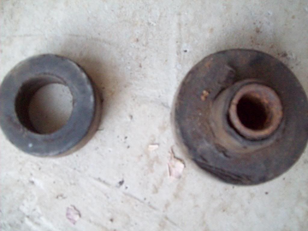

thanks gwfisherman.hrer are some pics of my 2'' body lift used bodymounts from an 87 gw.
