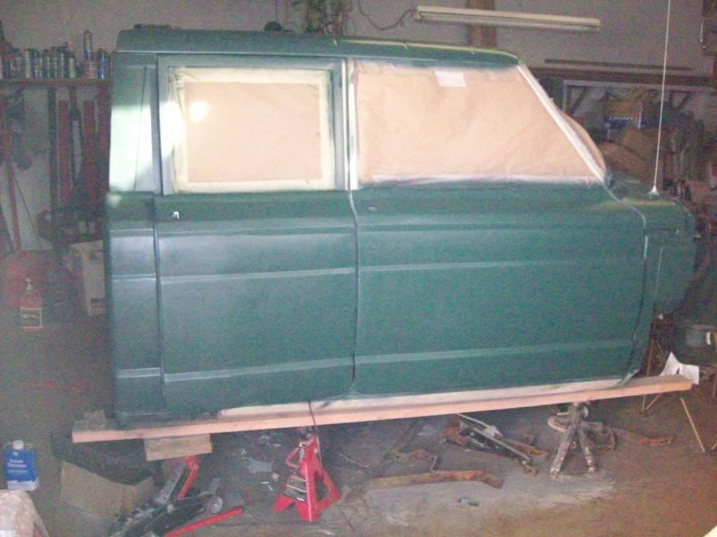

the bondo work is almost done.this will be the color of the crew cab.(hunt club green)
the doors are almost done.they work, just need to adjust the door guts so the windows will work.

at the rear of the doors i used about a quarter inch of bondo.shaping the doors to match the body lines.i have used over a half gallon of the bondo.
as for the brand it says bondo.i got it at homedepot.

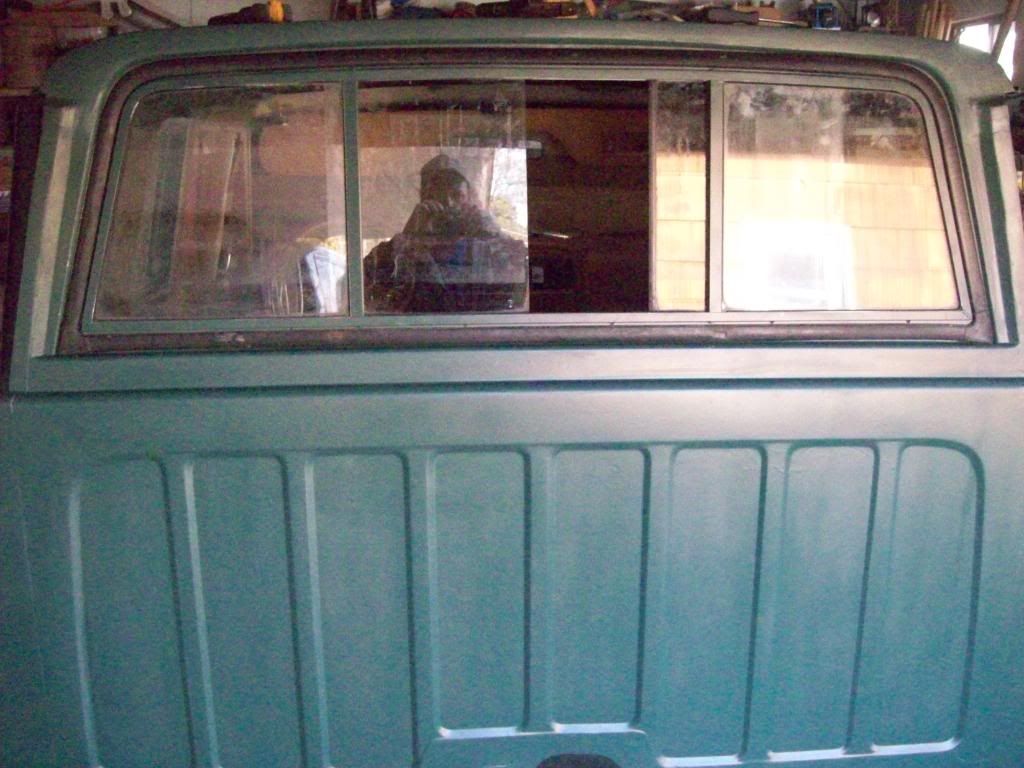

got the rear window in today
and here is the full side veiw for you blair.

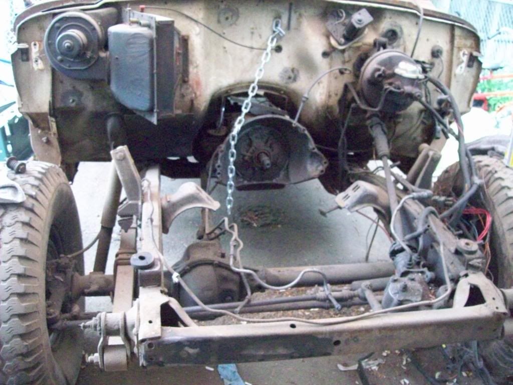

the other pics are of the front clip removed,frame sanded and painted.the core suport and valiance installed.
the shock mounts and engine brackets are also repainted.
so i'm only a quarter of the way done.

rear window
great looking work!
is the rear window gasket new? if so where did you get one?

i got the sliding window and seal out of another j4500 that i scraped last year.
you might want to try jcwhintly or teamgrandwagoneer,zmjeeps.bj's offroad.

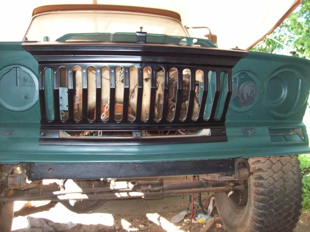

here is my would be rhino grill.

i like the grill defenatly diffrent and cool
