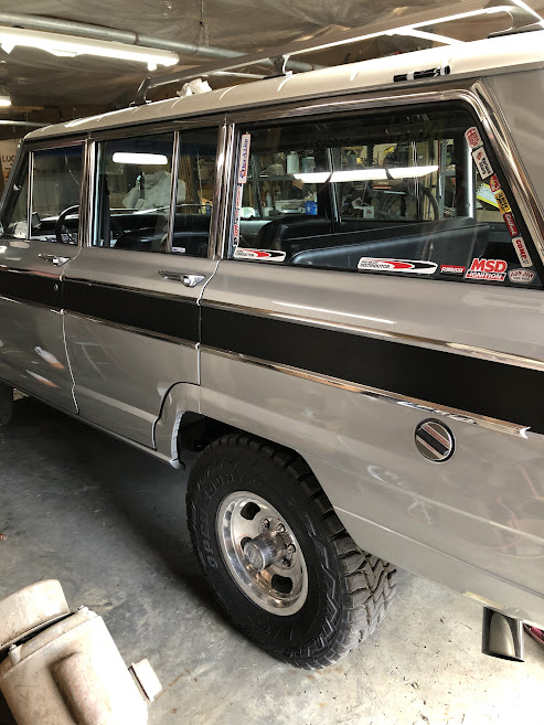

Gathered up my stainless trim. I have two sets, but some is damaged. I 'am taking the best pieces and cleaning and polishing as I install. This is what I did to get it looking better.
1. wet sanded with 600
2.wet sanded with 1200
3.wet sanded with 1500
4.wet sanded with 2000
5. polished with white diamond

This was the first piece I put on. Been a long time coming.
1978 Wagoneer
Mods:

It kind of reminds me of what is on a super wagoneer except in black.

WOW!
Just WOW!
That Wagoneer is so pretty!

SON OF A GUN !!!!!!!
I knew it,....
I just knew when the black was bordered by the polished stainless
it would pop like crazy,....CONTRAST is what my art teacher said was key !!!
bright polished beside black carbon fiber = Winner.
"long time coming" I can relate ,.....had one project that took 5 years,
...putting on those final details is better than x-mas.
looks great, ready to see a pic of the entire side with trim.
dave in NC
