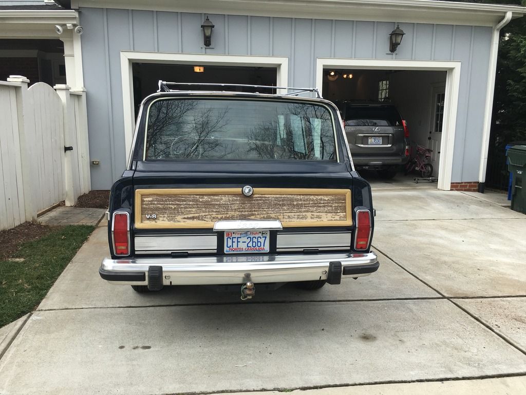

  #43
Old 03-13-2016, 09:21 AM
asudchiman's Avatar
asudchiman asudchiman is offline
Join Date: Feb 03, 2016
Location: Carolinas
Posts: 688
The next step
At first when the bumpers were still wet following the BKF treatment, they looked fantastic. Unfortunately, once they dried the oxidization came back.
So I took it to the next level. From reading the forum and a few other sites I attempted the following process:
1. Wipe down the bumpers with a thin coat of paint thinner. Do not go crazy here. A little is all you need.
2. Use a professional car polisher (mine is a random orbital) and meguiar's ultimate compound to polish the bumpers to a mirror finish. Take your time and work side to side and up and down. Don't rush it. Let the polisher and compound do its job. I set my speed to a 5 out of 6 for this step.
3. Wipe off any remaining compound with a clean microfiber towel.
4. (I have not done this step yet) Once satisfied with the bumpers, finish with a coat of either collinite liquid metal wax or Ultima Paint Guard Plus (follow instructions exactly)
Here are the photos of the bumpers following polishing using this method. I still need to go over it one more time.
I still need to work on the lower section of the bumper before sealing it with wax/sealant (step 4)

  #46
Old 03-13-2016, 09:33 AM
asudchiman's Avatar
Location: Carolinas
Posts: 688
The 15 foot view
Here is the rear bumper from 15 feet away. I think it turned out well.
The deep scratches and some oxidation is still there, but it passes the eye test now from 10-15 feet. Later once I get other upgrades done (i.e. wood grain, etc.), I will come back and work on optimizing the shine.

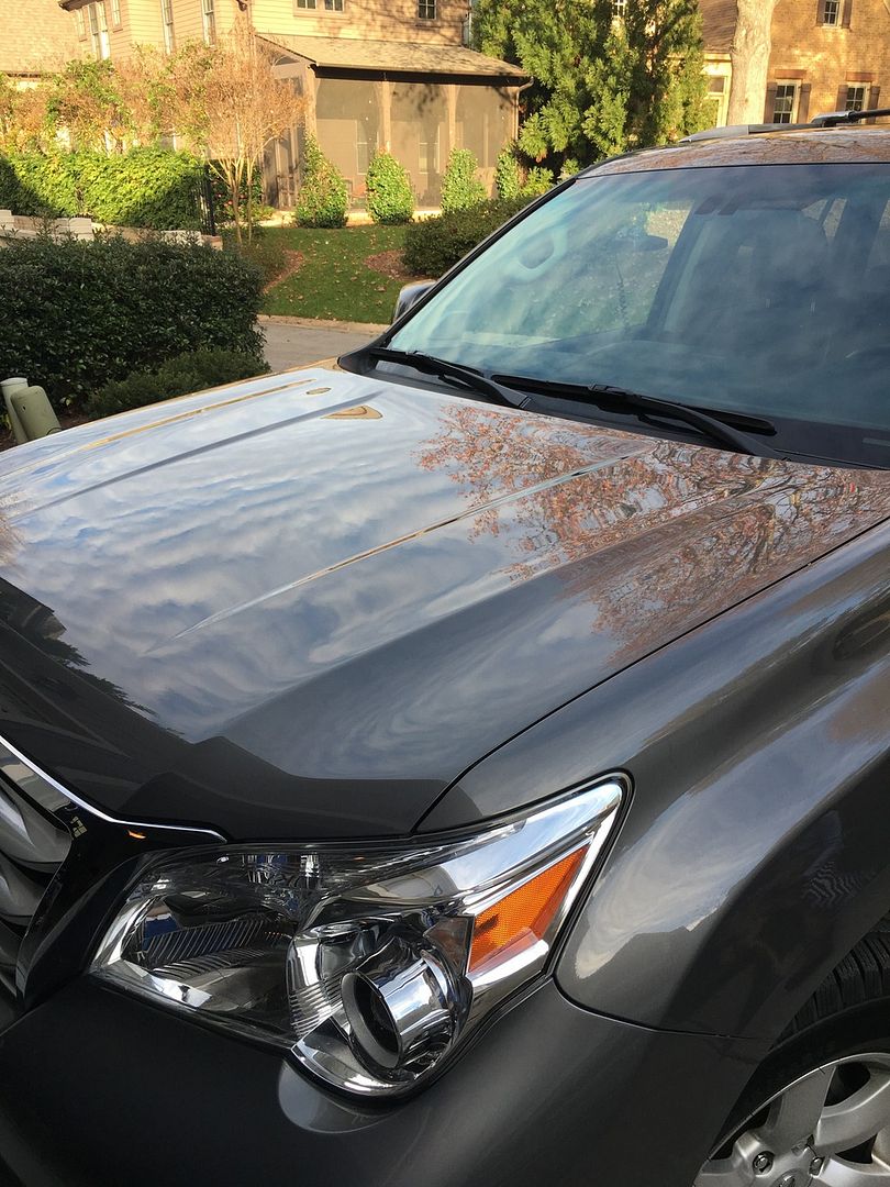

  #51
Old 03-13-2016, 05:44 PM
asudchiman's Avatar
Location: Carolinas
Posts: 688
(Non Jeep Post, but waxing post)
As promised:
Here is a photo of my 2011 GX 460 after waxing.
I used the following steps:
1) Wash
2) Ultima Paint Sealant (Long lasting protection a beading)
3) Collinite Fleetwax. This gives the mirror shine and reflection.
Those are not ripples in the paint, it is a reflection of the clouds. I have to admit I thought my camera messed up when I first looked at the photos.
