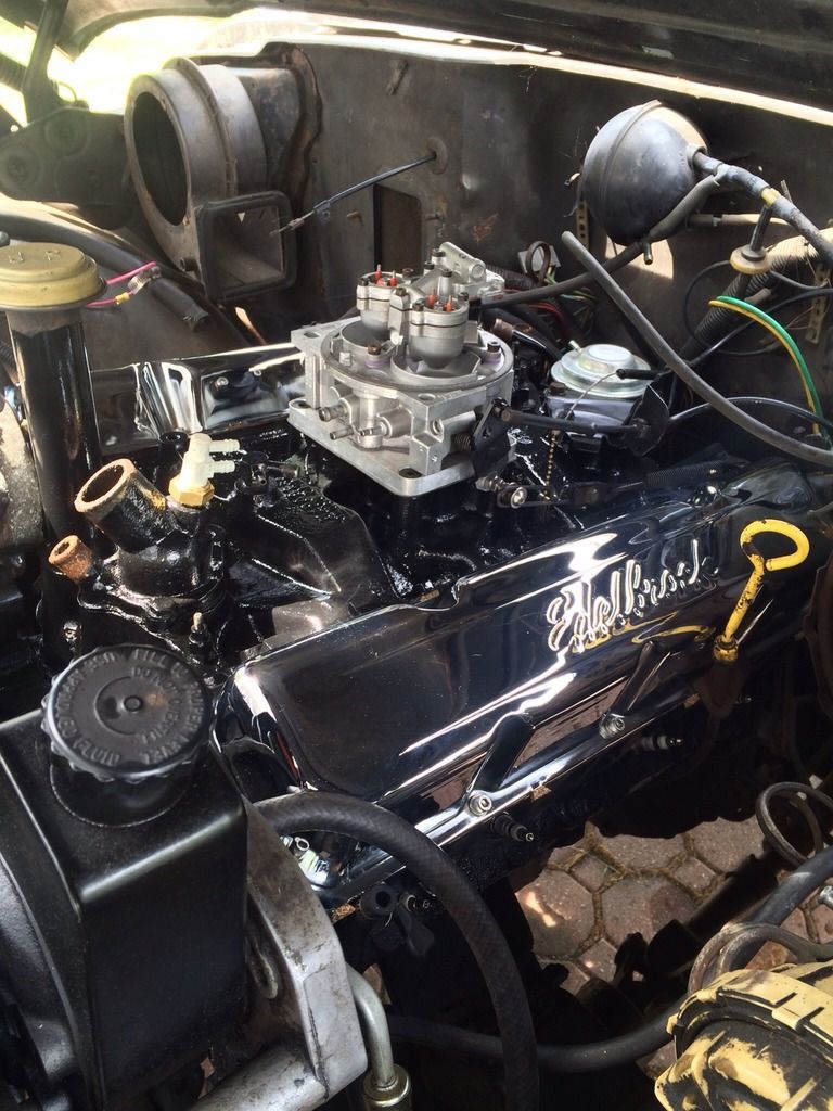

I've also been working on the Howell Fuel Injection Install. Installed a new CTO in it's new location and installed the TB adapter plate and the TB.
New gasket for the choke stove
Throttle body installed
Can't wait to put the new chrome valve covers on. It should look pretty good.

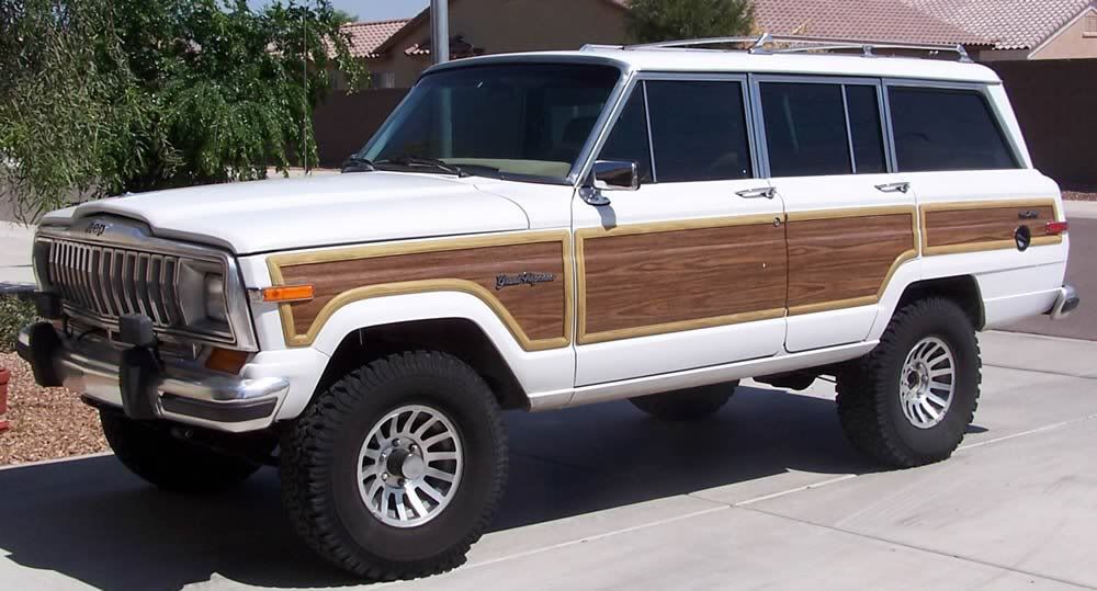

I'm still a week or two away from my install. But here's a couple pics of a 4" lift with 32" tires that I found and ultimately made my decision for me.
4" Lift with 32" BFG Mud Terrains. Very nice!!
4" Lift with 32" BFG All Terrains. Also very nice!
I decided to go with the latter. Although I love the look of the MT's the reality is about 95% of my Waggy's driving will be on pavement. So I decided to go with the AT's. Plus I had some on another Jeep I owned and they were great. I went with 32's instead of 31's because I feel they fill the wheel well a little better and look better with the 4" lift. But that's just my personal opinion. Hope this helps!

Great looking rig you have going! I agree that 4" BJ's lift and 32's is perfect.

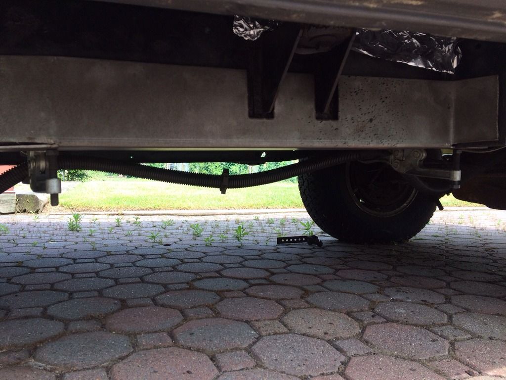

Checked out the undercoating. Looks like it came out well. Hopefully all of the prep work I did will make it last. But so far so good.
Also here's a pic of the frame rail repair piece clamped into position after some fitting.
Note the tin foil in the top of the pic. It works great for wrapping the frame and anthing else you don't want to get undercoat on.lol
