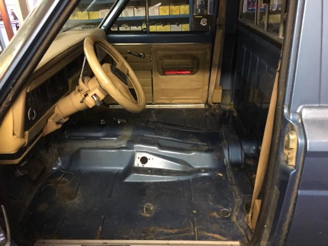

So, next step was to start the teardown.
Into the garage.
Off with the front clip. No rust, all the bolts came right out. Just a lot of mud.
Lots of dirt in the cowl...
Lots...

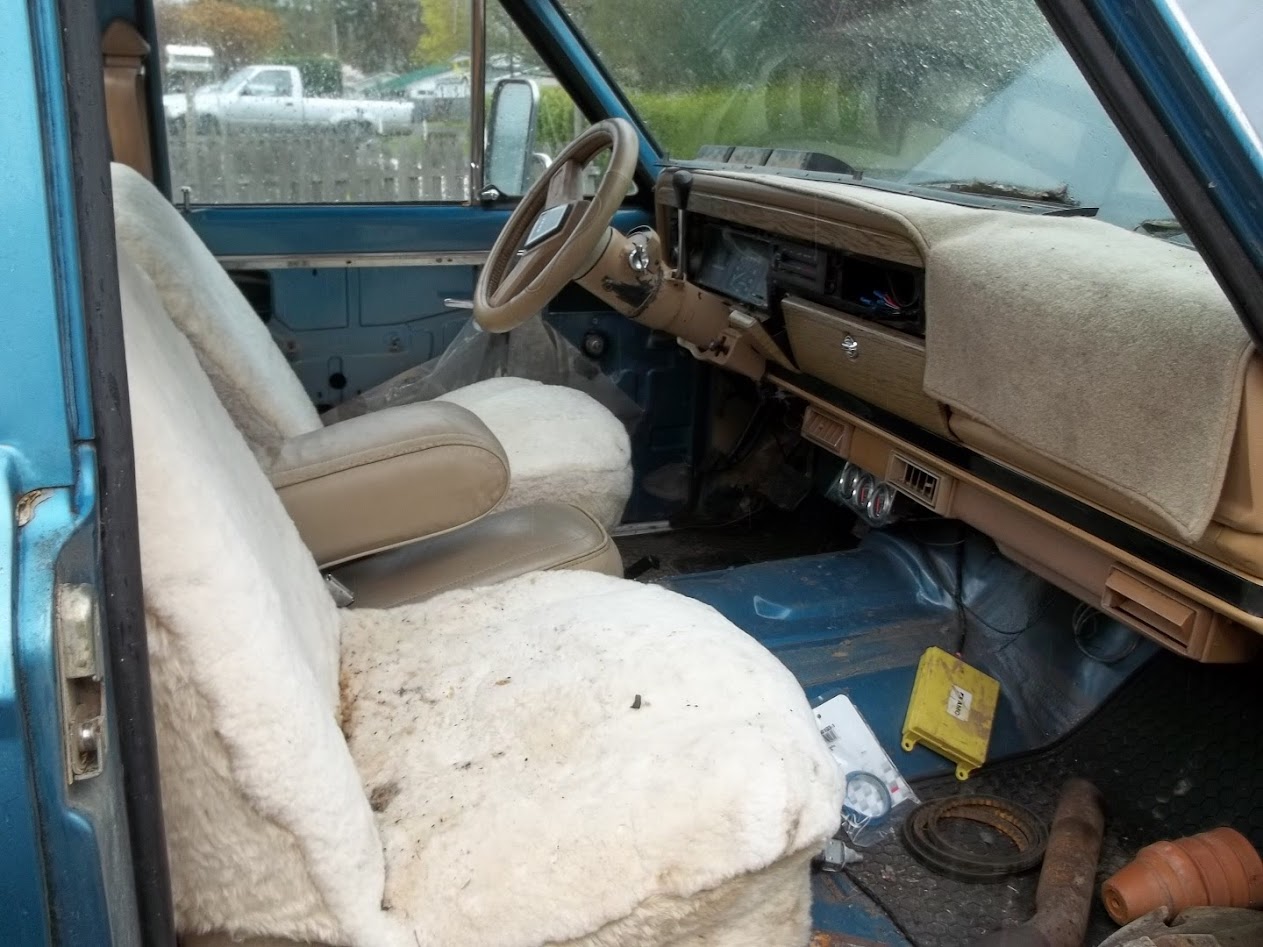

Next step was to remove the cluster and dash bezel. I forgot how much fun removing the actual cluster bezel was. Whomever in Jeep decided that the defroster vents needed to be attached to the back side of the glove box with one way speed nuts should be shot. My hands look like I went the rounds with an angry bobcat. But- the good news is that Jack the Ripper of wiring was unable to get to the wiring behind the dash. I removed a bunch of scotchlocks and what's left looks to be in great shape!
I gave the bucket seats one last try, but even with a smaller steering wheel my beer muscle just gets in the way. It all worked out well- I traded with Frank Ziebert my buckets for his bench seats, I'll be able to make one good bench out of his two.

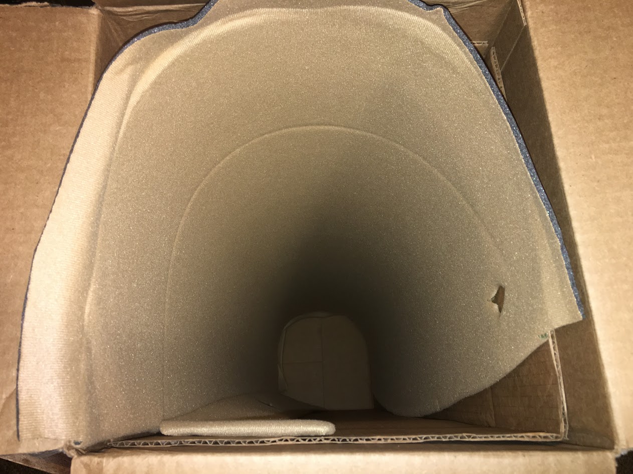

All this dash removal was in preparation for the install of a Vintage Air heat/cool/defrost unit. It's a servo controlled unit, smaller than the Magnum but it should be plenty.
It fits like a dream! Passenger view-
View from down low-
Lots more fabrication will be involved with the A/c install- I'm planning on cutting in the vent registers into the black strip at the bottom of the dash, and then I still have to adapt the defroster vents and fill a bunch of holes in the firewall.

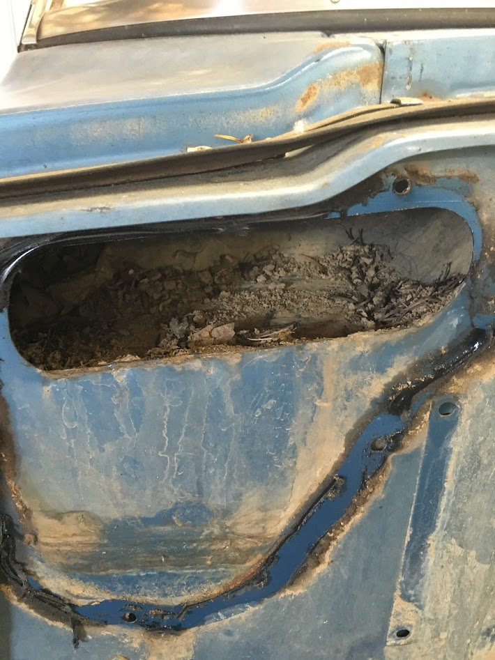

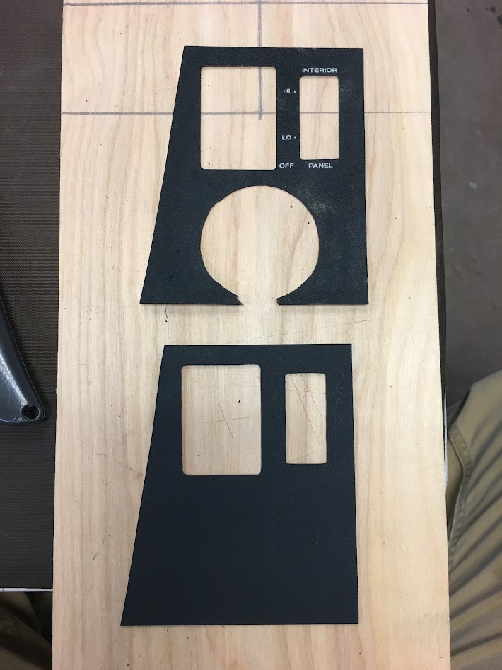

So, with the dash out, I decided to repair the area under the headlamp switches where the PO had installed a pyrometer. I got a sheet of thin Kydex, and cut a replacement applique. Came out pretty good. No lettering but that's OK. I might put the dual tank switches in the blank area. I also repaired the headlamp switch retaining tabs and cleaned the contacts on the dimmer.

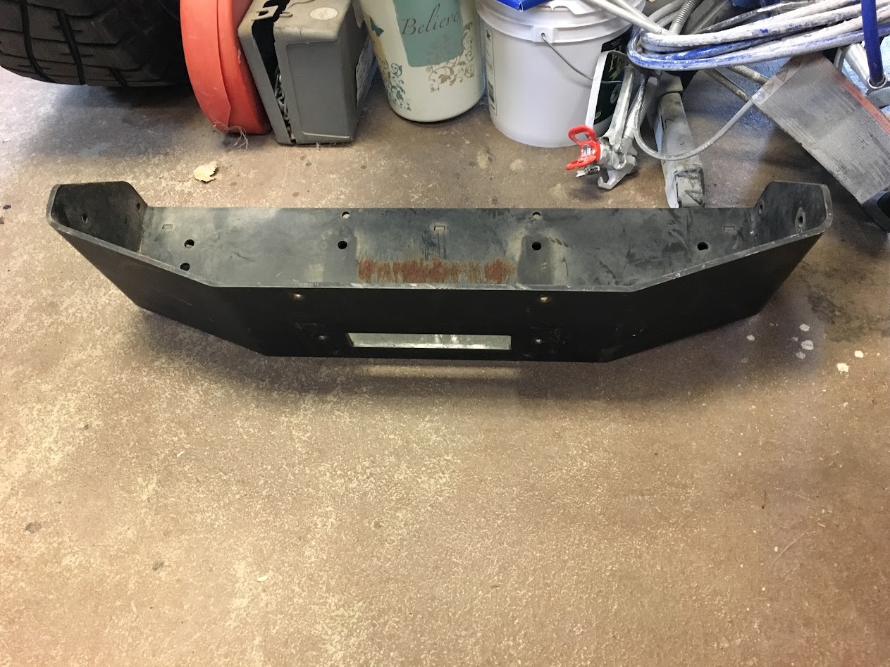

Also found a nice Warn 8274 and a mount on Craigslist. I'm going to integrate the mount into a factory front bumper. May use the 8274 or may get a Warn 10K.

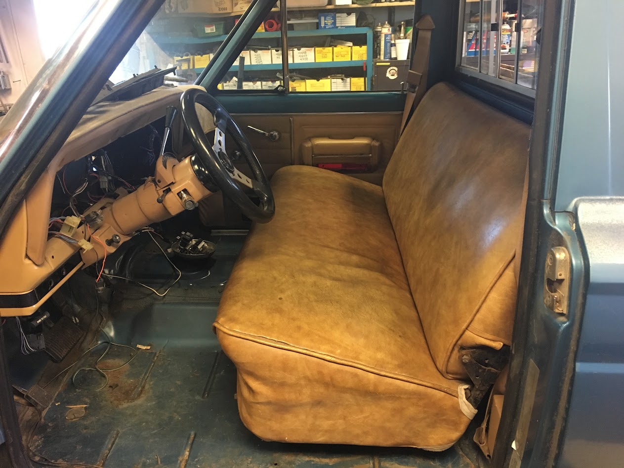

Well, with this post I'll be current. I was watching Craigslist, and found a cheap set of BFG All Terrain 265/75/16's. A few posts later there was a set of wheels I liked, also at give-away prices. Bought them both and mounted them right up. 7" wheels with 3.6" backspace put the tire tread right at the outer edge of the flare. Perfect! And the skinny tire on a skinny rim give it just the old school look I was going for. Plus the wheels are one of my favorites.
So today I got busy working on making one good seat out of the two I got from Frank. Both seat backs were good, but the bases were another story. On one there were only 4 springs that were unbroken or not missing. But that was OK, because there were only 3 broken on the other one. After a quick spring transplant, I had a good seat. I installed it just to see how it felt- and like I figured, the bench seat is perfect of someone 6'2" and 280 lbs. The only bad thing was the cushion springs were so fatigued, and the foam so deteriorated, that it is way to soft and "lumpy". I've been researching fixes. One is to rebuild the base springs- new perimeter wire, new no-sag springs (the ones that look like a chain of S's), and new burlap and thin layer of foam. The other option is to buy a chunk of quality upholstery foam, build a support base out of either sheet metal, suspension cord, or straight stretches of the no-sag springs, and then carve a new base cushion to fit. This would replicate modern seating technology, and actually sounds good as I could then contour the cushion to get some raised areas to keep my butt from sliding around. I'll post up a step by step once I do one or the other- I'm guessing a lot of us deal with saggy seats. On our Jeeps.
Here's a pic of the bench installed. it looks huge, I'm guessing it's like that because whomever reupholstered it used a couple of layers of carpet underlayment foam and some automotive carpet over the top of the deteriorating factory foam. Double wrapped foam around the front wire makes the seat base look strange.
