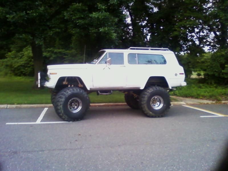

10 in chevy springs in the front and custom 3 in wide tall ford f350 springs in the rear.no bodylift. 44 inch groundhawgs.
mark<br />76 cherokee chief<br />chevy 502 t-400 np-205<br />dana 60 front corp 14 bolt rear<br />fiberglass fenders and quarters<br />(ABOVE THE LAW)(AND UNDER CONSTRUCTION)<br /> [IMG]<br />[url=http://www.fsjworld.com/mygallery.ten?id=3481[/URL]<br />[/IMG]
