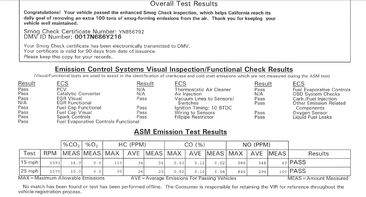

Old 04-18-2018, 05:52 PM
Posts: 9,372
The only stat I worry of (a little) is NOx. I get a little worried the increased CR will increase combustion temps and increase NOx. This is in my simple mind though, I have no data to back that up.
EGR and/or dial timing back couple degrees, would get you through.
My '90 passed last time even w/o the EGR functional(forgot to hook it up).
It has a cam, believe the "RV" grind, but dunno for sure.
Look @ NOx on below smog tests...without & with EGR.
