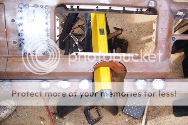

I like the pre ’73 dash but the instrument panel is too small for the gauges I want so it’s getting modified.
The housing gets narrower toward the back.
Removed the corners.
Removed the sides and made a hammer form to flatten out the taper.
Reinstalled the straightened sides and put in some bracing to hold the shape and give something to clamp the new corner pieces to.

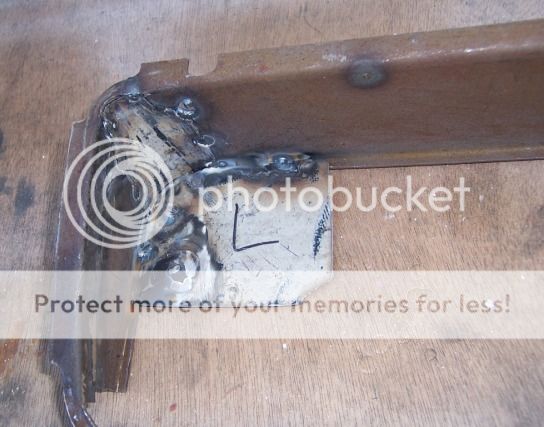

When you turn the welder down, make sure to verify the setting.
First corner complete.
