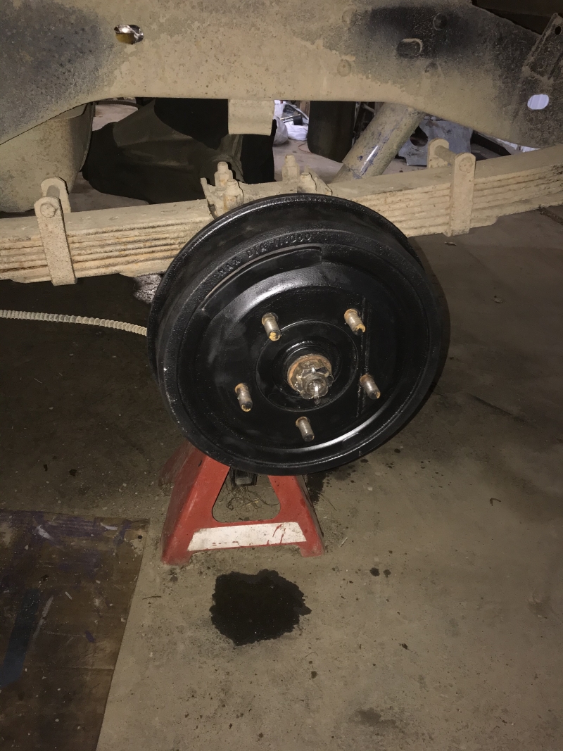

Haven't posted in a few haha, lots of stuff done. Painted the transmission, did a rear seal on it, new clutch release bearing, assembled the engine, then flywheel and clutch, and remarried engine and trans.
This week I plan on putting the engine into the truck, its in the shop again, i had it in the back of the yard beside my other project

Put the engine in the truck, transmission and transfer case too. Driveshafts are in and the exhaust is too. Put a new brake line around the front frame cross-member and ordered a master cylinder rebuild kit (NOS )
Volt, Temp and Oil pressure gauges are mounted and wired up.
I used my eBay parts to rebuild the parking brake system and it works great (needed equalizer and the clip to hold cable onto trans cross-member). I lost a trim on the passenger door and put some 3m chrome trim on there and it matches up quite well.
New throttle
I did the rear axle seals, re packed the recently replaced bearings, new cover gasket, and set the end play PROPERLY. Before i opened this can of worms it had 27 thou clearance . Now it has 5
Factory Spec is 1-6 thou.
It was because he (previous owner) put it together in the wrong order, and the cup was wayy to far out.
Painted the hubs and brake backing plate and the drums but not gonna do the back frame yet as its a project for another year when i get the box off and whatnot.
Put hubs on and put key way in after, then got them to at least 180/190 ft lbs then new cotter pins
Did the pinion seal too (oil was leaking out of everything on this truck hahaha)
And re-torqued the yoke nut to 200 ft lbs
Endplay Before:
Yep... Shes a 53 for sure
Runs smooth and shouldn't leak oil now.
Whats left now is to finish with the brake master cylinder and bleed the brakes. Then put the front clip on and finish the wiring.
I also mounted the toolbox I made in shop class and put the tools i got fro Christmas in there, also got a couple stickers on it
Its a 55 gallon drum mounted horizontally on saddle mounts with a curved aluminum checker plate door, its lockable and has a good seal.
