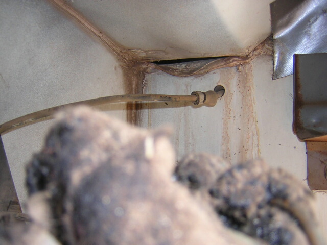

There should be a hole in the kick panel up under the dash that the antenna wire comes though. This goes into the inner fender area that forms the fresh air vents at your feet. The area between the fender is inaccessible, so there can't be a clamp or such in there unless someone pinched the wire when replacing the fender or something similar. If so, I'd probably cut it off and push the remaining cable into the fender, and use a stiff wire to find the route between the cowl-top hole and the hole under the dash.
Here's what it should look like under the dash.

Originally Posted by tgreese
WOW Look at that wonderful factory caulk job! No wonder why these things are leakers!
Probably why my cowel leaks onto the passenger floor, and of coarse I can't fix it unless I cut the jeep apart
Arizona truck - not surprisingly - the floors had some rust. Picture was originally taken to show the leak location. You can seal that gap without cutting the cowl open.
